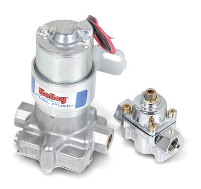

This is what I did when I put in the TPI system. I bought a new tank with welded baffles from rockauto.com and an ebay sending unit. Then I bought a Walbro pump. I can barely hear the pump when the engine is off.
The pump was quieter with the bypass regulator. I just need a larger return line to use it.
fyi find a way to mount that fuel pump on some rubber isolators like msd uses for there ign boxes. that noise would drive me nuts even over the exaust. :doah:
Thats the loudest fuel pump I've heard what kinda pump is it. My walbro 255 isnt even that loud.
Its a Holley Blue fuel pump:
