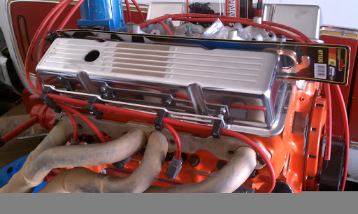

Anyone have a good mounting solution for their spark plug wires?
I like this setup. One of these days, I will actually get the motor back in the truck. To use any of these type of spark plug wire brackets, you have to use the cut to fit wires. I've never gotten the fitted wires to route the way I wanted.
Made for you vertical mount. Summit sells them. I run their stuff where ever I can.
i'll second the Made for You products... when it comes to plug wire routing their stuff is the nicest imo... quality product...
