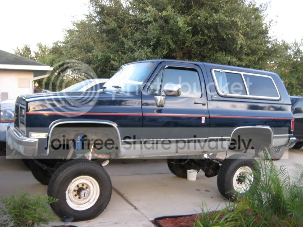

im trying to decide what to do about the rear lift....this is a BUDGET build and i have aal's and 4in blocks right now....im thinking about getting 8 in springs so i dont have to mess with dropping the tank and all the bs for the shackle flip. any input??? how hard is it to drop the tank???? i installd a flip on my old truck but htat was a pickup, so it was easy as can be.

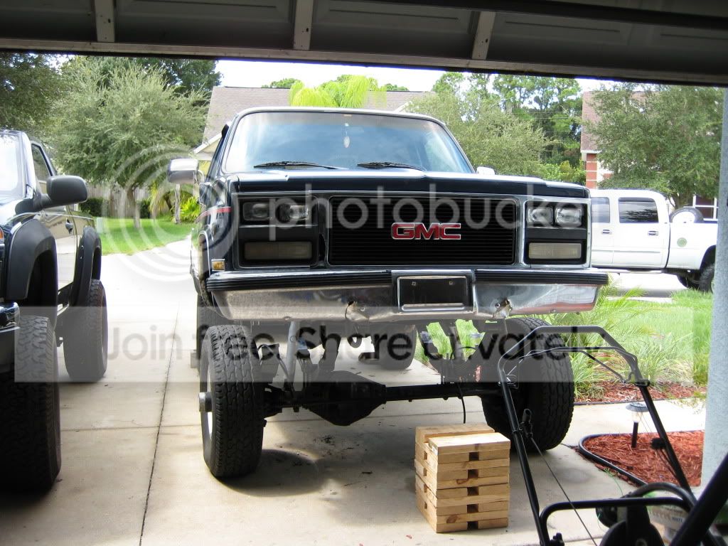

you have any pics of your truck on the jack? i see the stack of blocks...did you lift the truck as much as possible and hold it while you lowered the jack and added blocks under the jack,..then raise the truck more then repeat, until you had the truck high enough?
i have a pair of front 12'' & 8'' rear swamp runner springs w/4'' block(i have diy's shackle flip to rid myself of the blocks) and i have no way to lift my truck high enough to install these springs & my d60f axle lifts another inch & i want to install zero rates to move my front axle forward, which puts me 2'' low in the rear.
so, i may have to put zero rates & longer shackles in the rear or a 2'' block...i hate blocks and will do anything not to run them! but, i dislike the body lift even more..which is the reason for these springs,...replacing 8'' springs and 3'' body lift.
i built those wood blocks. i got the idea off pirate... it's 2x6's that i bought and cut down to 14 inch lengths...then stagered them like that and screwed each stack to the next...very simple and very storng..... it got the truck high enough so i could literally roll the 60 under the front (tires aired down) then put the ubolts up and air the tires up and bolt it all up. worked perfect..... that stack of wood is actually two of the stands i made...i just had them stacked up.

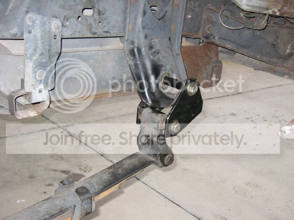

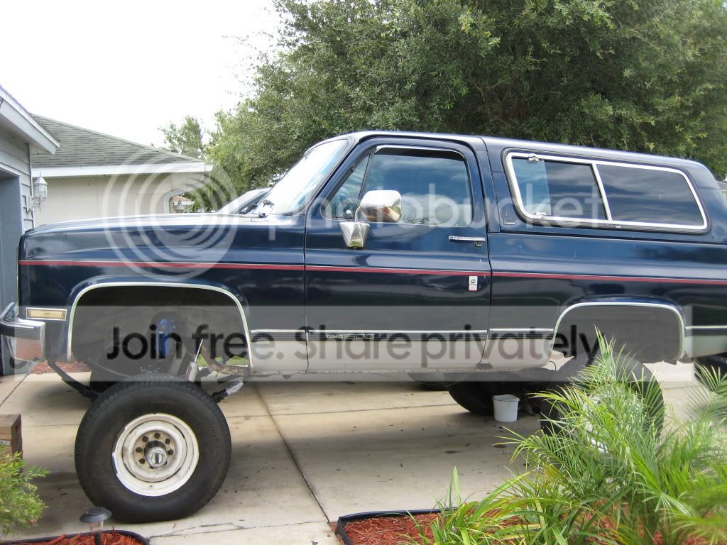

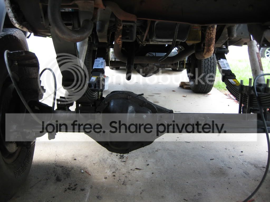

well, got the rear lift done...i found an echobit shackle flip and it was a PAIN IN THE ASS to install.....lots of grinding,cutting,etc.... it will be welded on though, but we ran out of daylight tonight to get er done.....
please ignore the horrible pinion angle and the powerade bottle in the front fender.
the 3 in body lift will be going on next week. this biatch is gonna be large and in charge.....remember, it's strictly a trailer queen and mud truck. haha.
anyways, those rollers are almost 35in tall to give you a perspective on how big she is....
You had to grind?? Those went on my stock brackets and didn't have to grind anything, but glad they worked for you.
yeah, i had to grind...it was kind of a PITA to be honest.... a BFH and a little bit of grinding on the echobit bracket where it meets the bottom of the stock hanger got er done..... once i did one side, which was the biggest pain, the other side was a breeze. haha....

so the echobit shackle flip doesn't require the removal of the stock bracket, good info. i have a set of diy's shackle flip for my k10. i also have a k5 i plan on flipping the rear shackles and it would be nice not to drop the tank or remove the rivets. who makes the echobit flip & how much lift does it provide?
well, the guy who was making them isn't anymore...because of fitment issues i think! anyways, i found one for sale off a member on here...and i also didnt' want to mess with dropping the tank/rivets.....i actually netted about 6inches of lift using stock shackles i know this because the front has 12 in springs, and my rear had an aal and 4in blocks(from the 6in lift....now it sits about level.
i'm going to fully weld the brackets in when i get a little more time...it's on the to-do list anyways...
hmmmm, it doesnt look like it would be that hard to build...is it 3 pieces? the 2 sides and the spacer on the bolt? i need to find 1 of these flips, heck i may could make them on a small scale.
exactly what i thought brother...the problem is with accountability...some jackass rolls his truck doin some stupid isht and it's all of a sudden your fault.
2 sides, bottom piece in the middle, and the spacer.
I didn't have any fitment issues on mine at all. The member that was making them just quit and bailed on a lot of people with their $$ not for any particular reason. There was somebody Wes (ThatK30Guy) I believe that was trying to replicate the design. IIRC it was advertised for 5.5" of lift with stock shackles.
