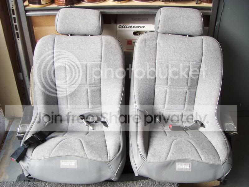

I purchased and received these seats in Grey. Although some comments indicate one size fits all, I'd say not really. I'm 6' 185lbs (thin) and their tight on me. However they fit my 8 year old like a glove, and my 5 year old loosely which is what I'd hopped for.

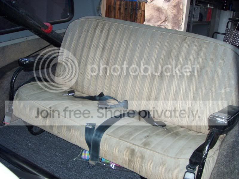

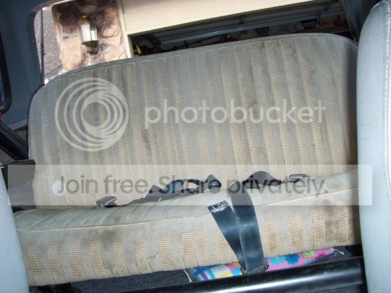

Old seat: FOR Sale BTW.

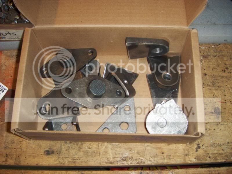

partial box of New DIY4X stuff :waytogo:

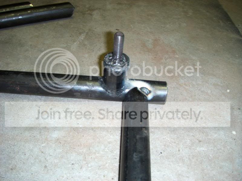

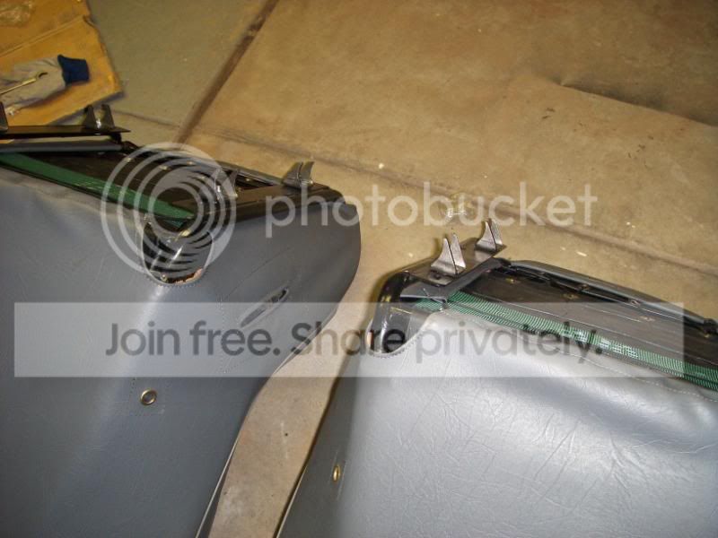

Closeup of front mounting points using the existing holes and reinforcements etc:

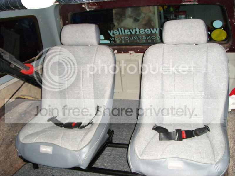

New Seats with new Corbea seat belts. I'll get harnesses later when the kids are a little bigger and I have a better idea of the cage plans, and obvoulsy a bender or a wad of cash for Dr. Smash to design build one.

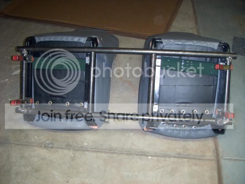

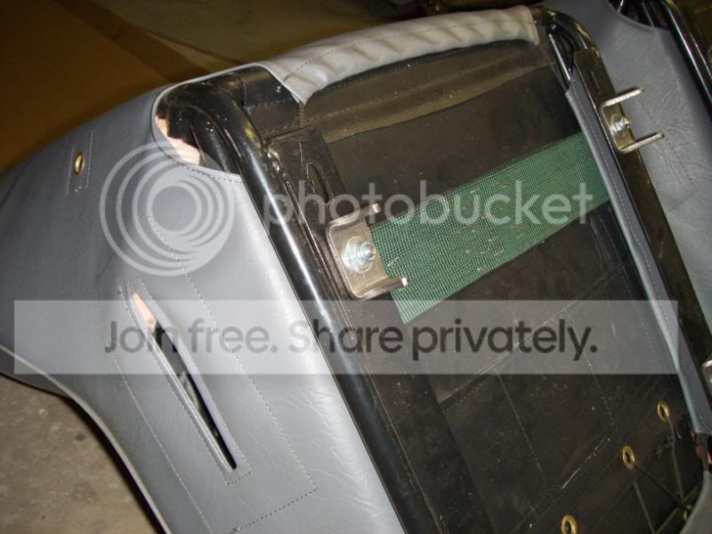

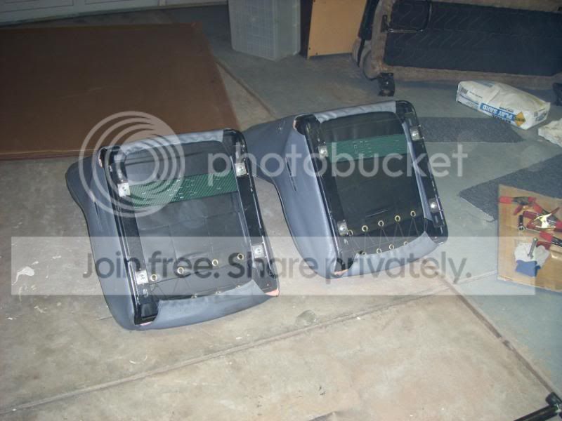

Hardware from DIY4X bolted to seats for measuring purposes:

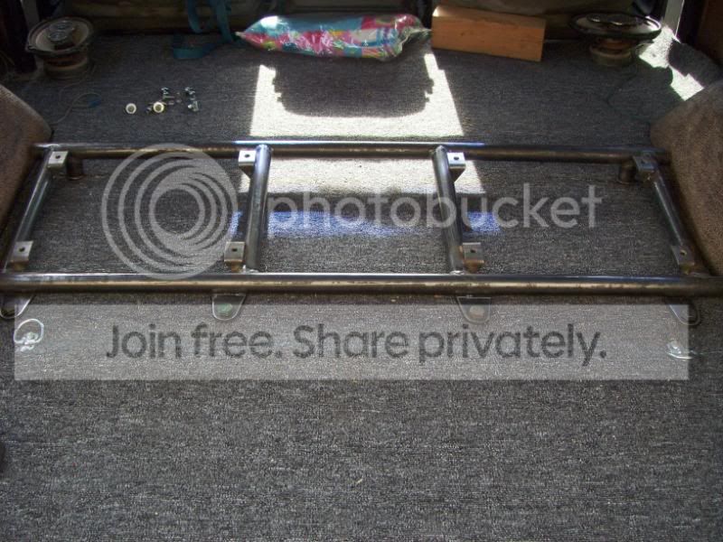

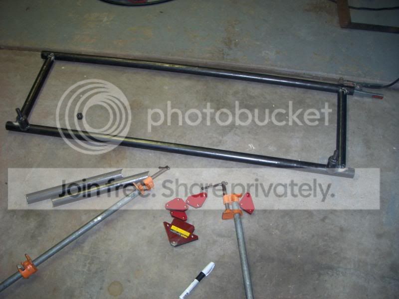

Frame tack welded and squared up. Used a chop saw to fishmouth the 1" ID pipe with 30 degree cuts.
Temporarily mounted again to the seats:
Test fit into place:

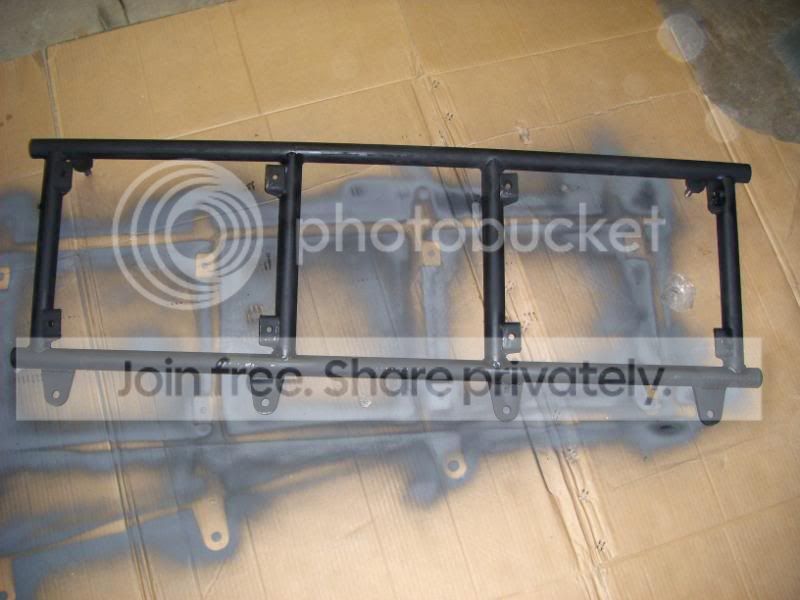

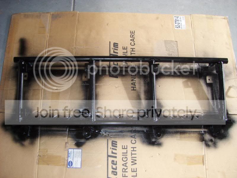

REmoved and primed:
Painted and drying for installation tonight:

interesting use of the panel mount tabs!

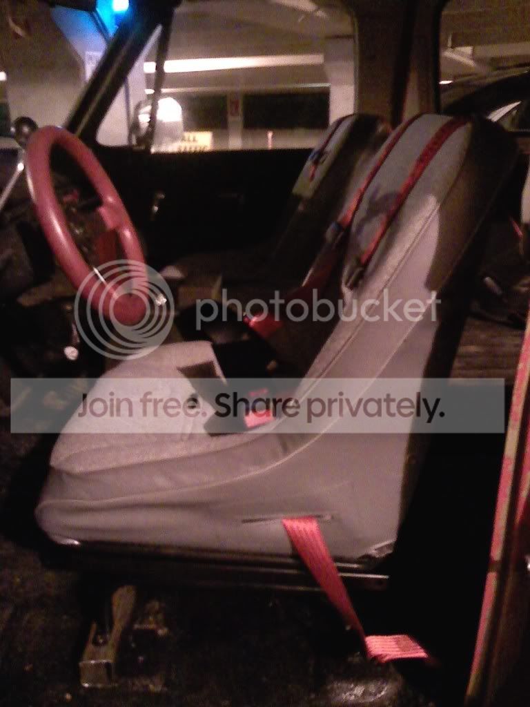

Sweet subframe Batman! haha:D Looking good! I just got the pair of gray buckets I ordered bolted in on Monday. Had a 4hr drive to Austin afterwards, and definitely more comfortable.
Done
Those look nice in the front and glad to hear their comfortable. My rear bench wasn't so nice.

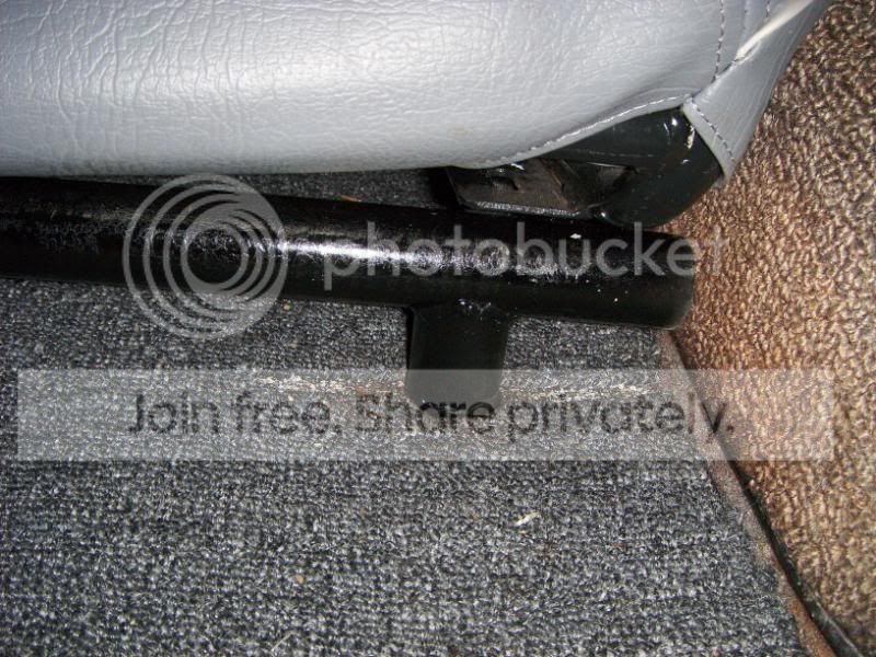

Rear seats and Frame - Done!
A little recline to the position for comfort sake.

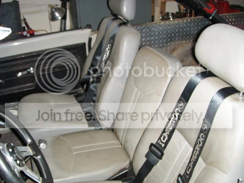

Existing front seats -
