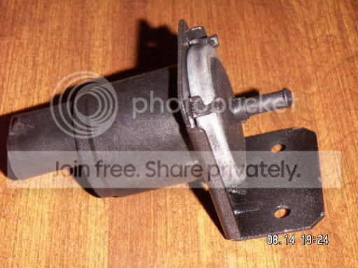

OK, on an '84 the "tip in" vacuum switch should be connected to the ESC unit to briefly retard timing for a quick drop in vacuum. This is to avoid knock. The wires from it should pass through the firewall to the ESC controller which is behind the glove box. I seriously think you can drive without it, assuming you plug the vacuum leak.
That being said, I do have a good one sitting here if you want to pay shipping + a few bucks...
The TC lockup switch is on the other side of the firewall, above the brake booster.

Is there another line to the switch?
Possible with one line connected, when the switch is "activated", a vacuum leak is created.

This is the switch I'm talking about. 1 vac line and a pair of terminals (Weather-pack 2-way).
When vacuum drops quickly, the contacts close.
