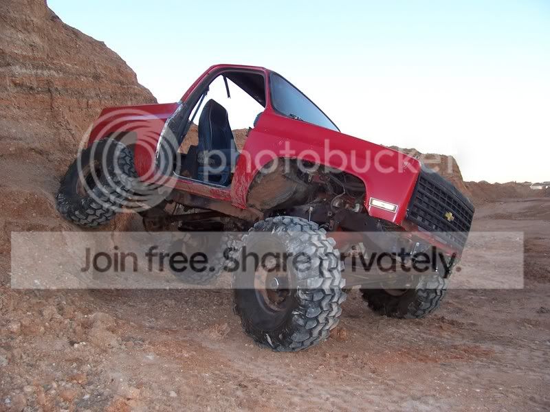

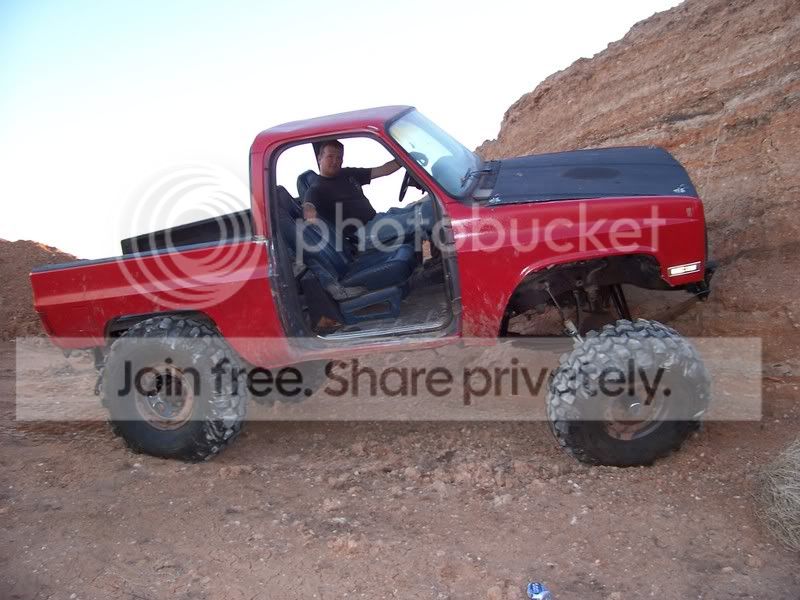

I was surprised how well they fit in and worked. After I cut them down they slid right in to where you see them.
what was the deciding factor in how far in you went? I was going to go to the body line in the hood. you went just past it. can you see an exposed edge where the hood is taller?
as for the blower motor. does the fender clear the tub by it and just the motor was in the way? or did you hack into the tub also?
I wanted to keep the grill intact. The hood actually sits down below the top of the fender. I thought it would sit higher but was able to get it lower. It would have been nice to keep it outside the body line but it was not to far from being there.
With the blower out and the fender skinned the fender was able to fit without cutting or adjusting the firewall.

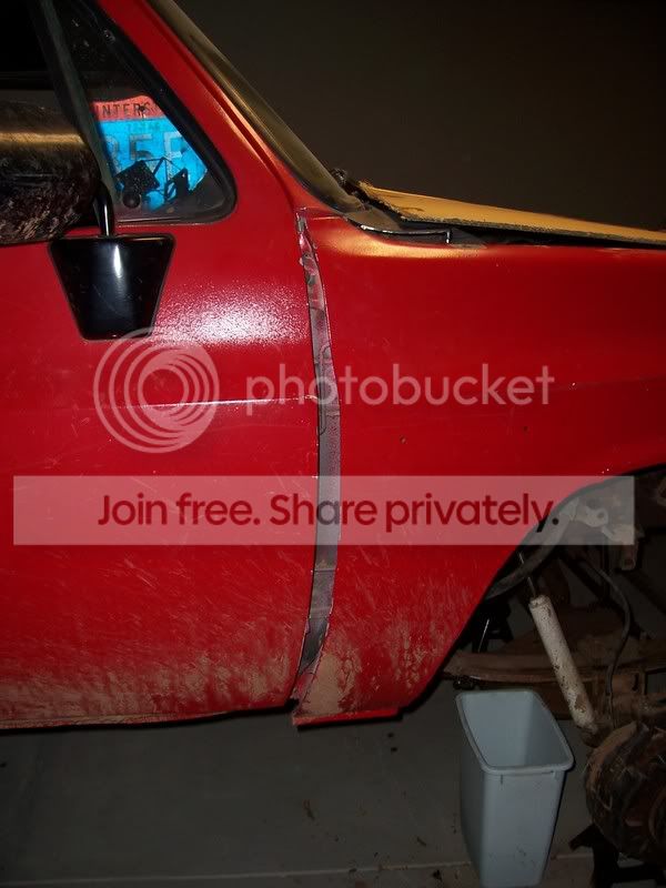

when you guys bent the front fenders in does it make the gap between the fender and the door larger or does it stay stock i noticed on cyberfires it stayed stock .or does it depend on how much you narrow it?
I think if you cut the fender or put a bend in it you can keep the gap the same. If you just angle the fender the gap will open up.
Here is what mine looks like.
It opened up quite a bit but I don't usually run doors so I wasn't to worried about it. I'm sure there are ways around it but I didn't want to spend that much time.
