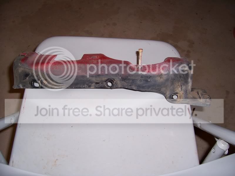

    Thought I would start off by posting what I have been working on.
    [​IMG]
    [​IMG]
    [​IMG]

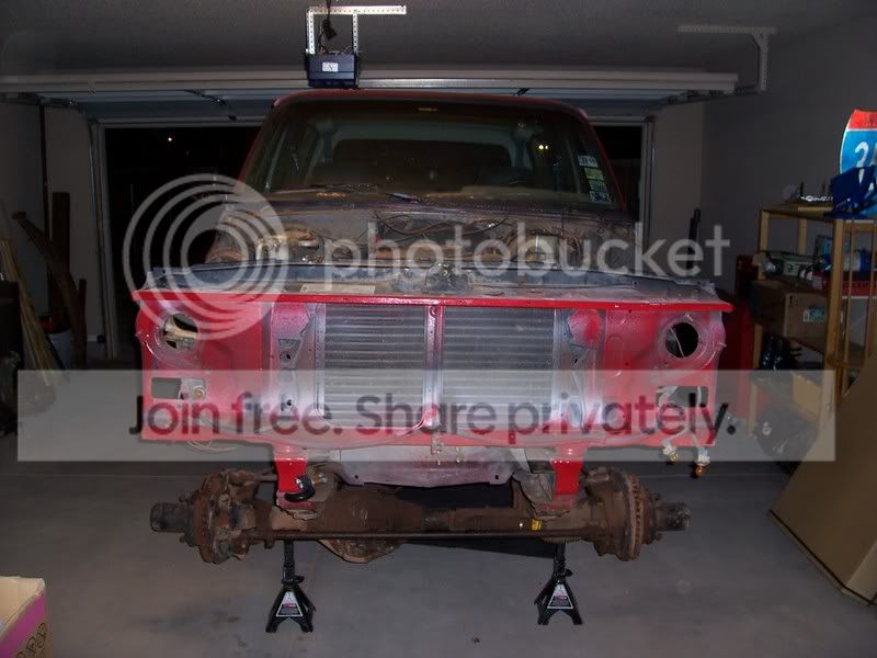

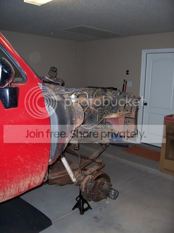

    Stripped down
    [​IMG]

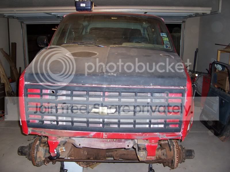

    Just had to see what it was looking like
    [​IMG]

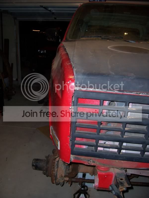

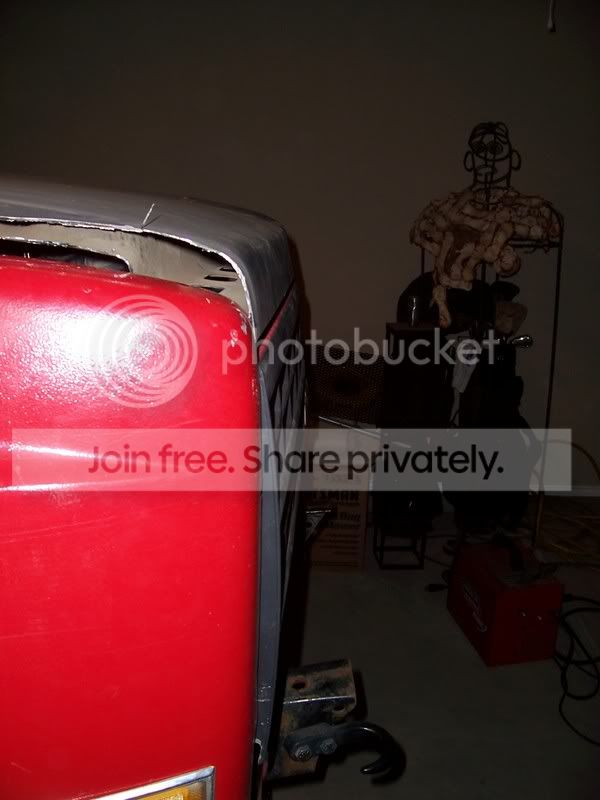

    Sectioned grill mount
    [​IMG]

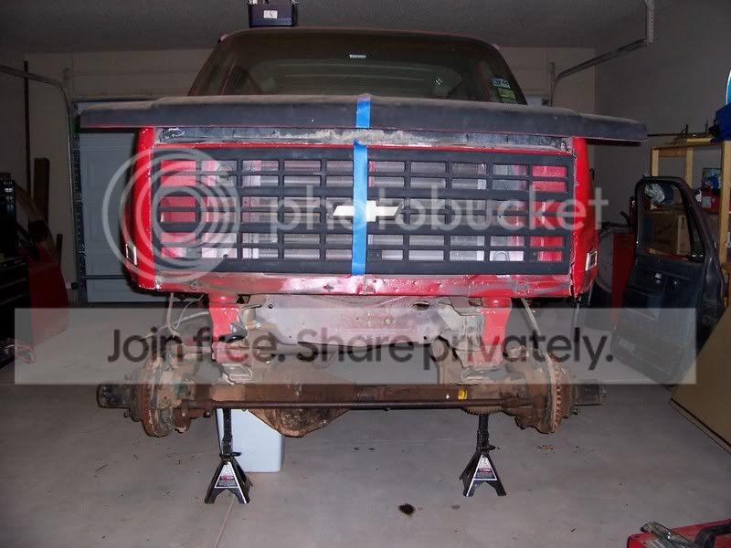

    To get an idea of how much I took off each side
    [​IMG]

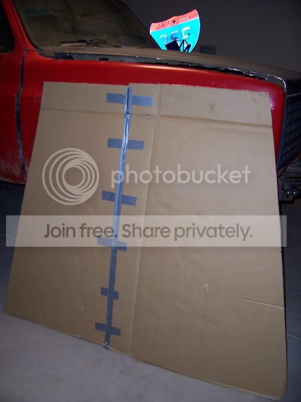

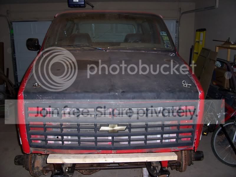

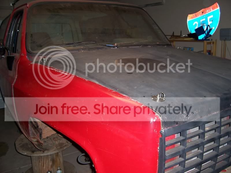

    Made a template for the hood
    [​IMG]
    [​IMG]
    [​IMG]
    [​IMG]
    [​IMG]
    Rough cuts on the hood

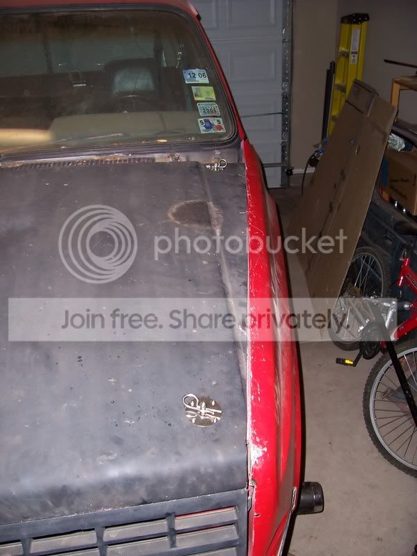

    Hood pins done and fitting as good as I can
    [​IMG]
    [​IMG]
    [​IMG]

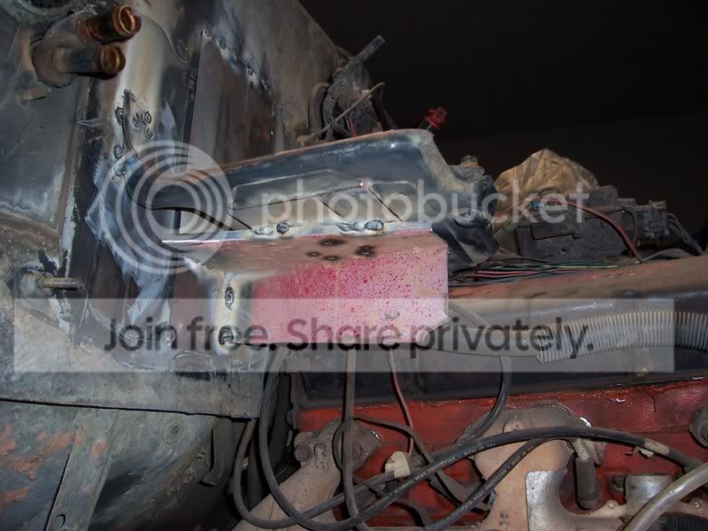

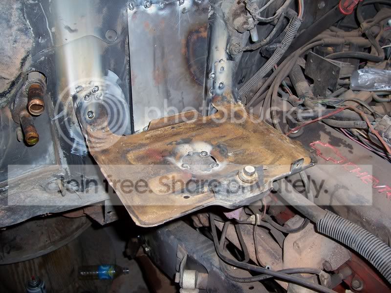

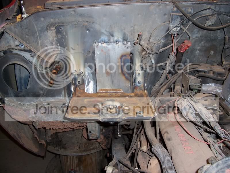

    New battery location
    The front is pretty much done. The rear is next.

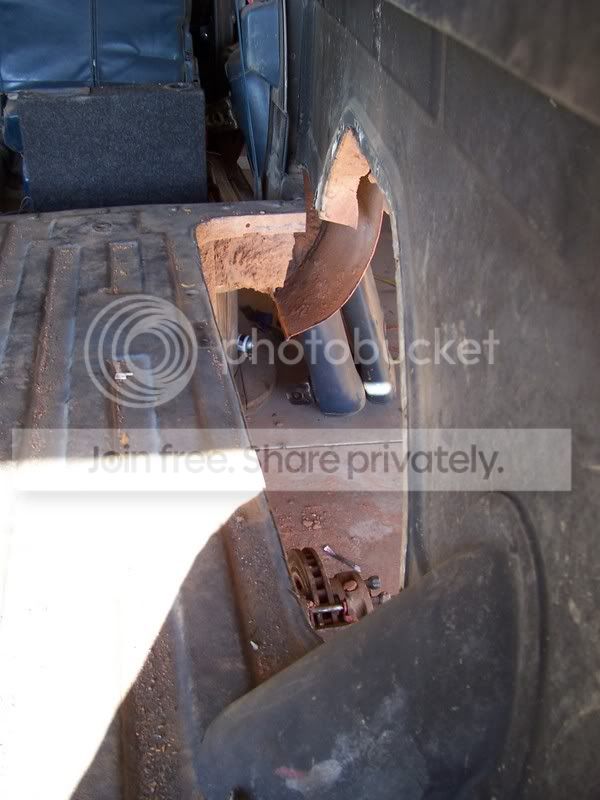

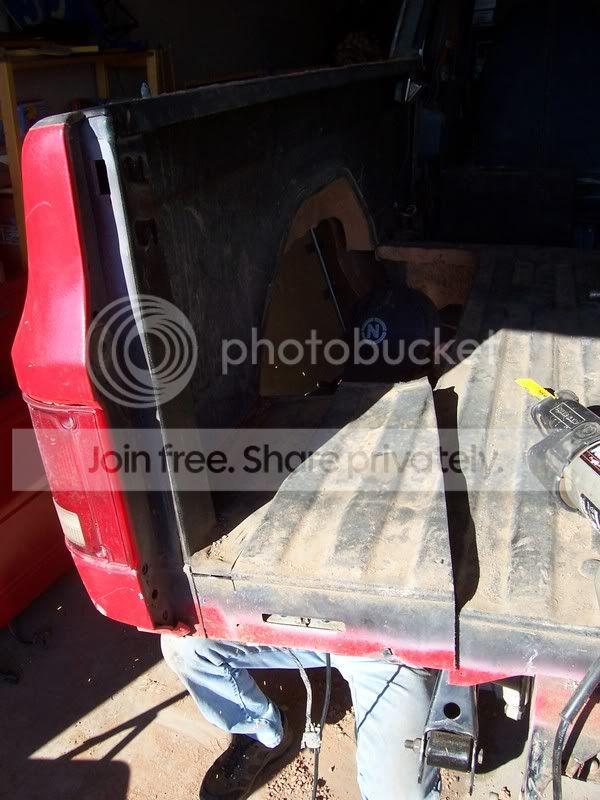

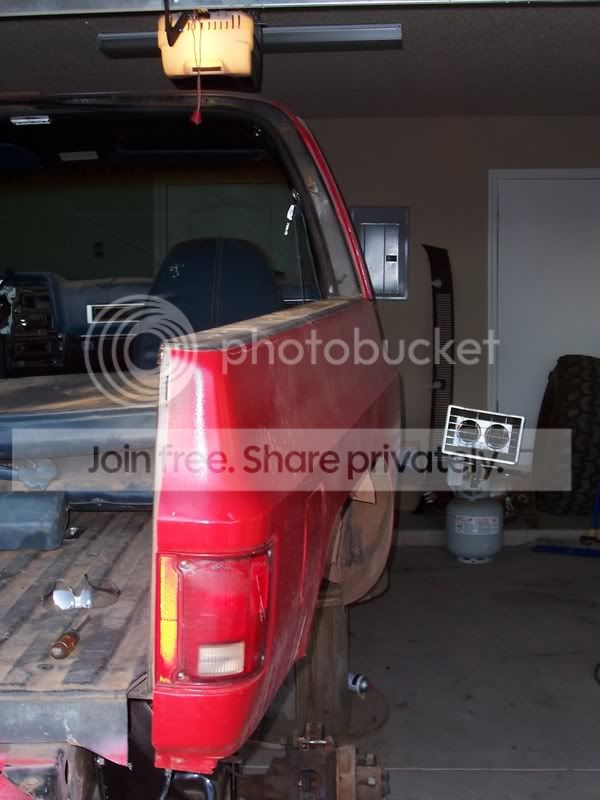

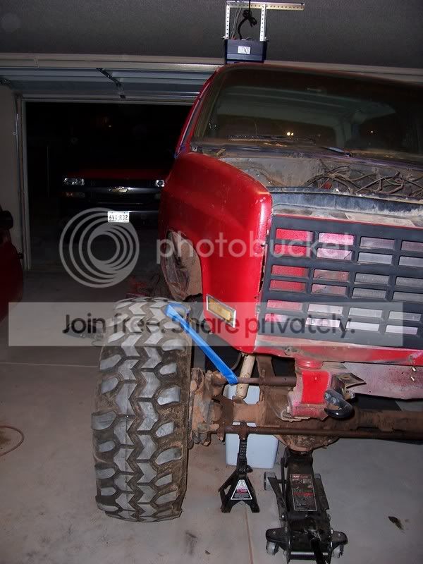

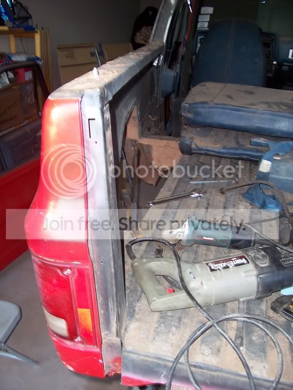

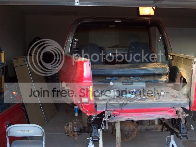

    Started the rear yesterday
    [​IMG]
    Cut out the wheel wells
    [​IMG]
    [​IMG]
    Whats left of the openings
    [​IMG]
    [​IMG]
    [​IMG]

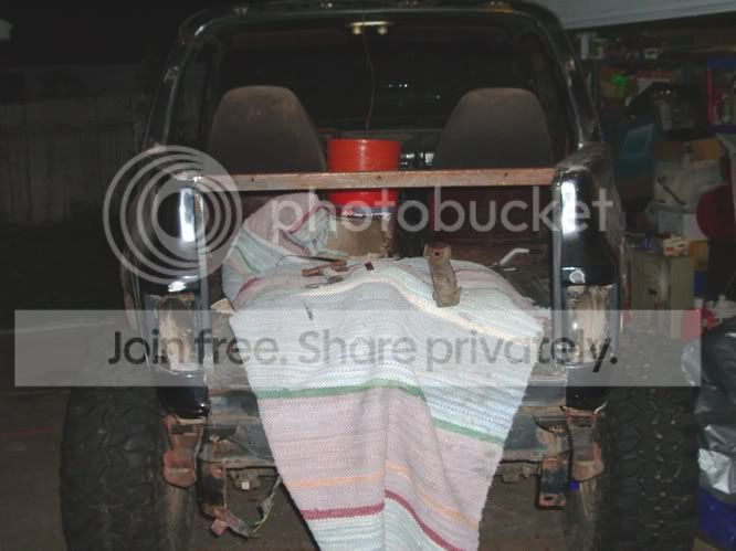

    Bed sides pulled in. This is as far as I got.
    Took about 19 in off the front and 22 in from the rear.
    Enjoy :hack: :grind:

    Cool deal!
    I would add some through bolts to your battery mount though, and possibly some gussets upwards. You might be surprised how much stress 80 lbs of battery can put on sheet metal...and you sure don't want the battery rolling around shorting out all over everything.

    I was thinking about that when I put it in. I have not finished it yet so I will look into that. Thanks

    Busted up battery trays was why i did this:
    [​IMG]
    Definitely one of the better mods i've done.

    I had actually tossed around the idea of doing that exact thing. I guess I will see how it works where it is and change it if or when it breaks.

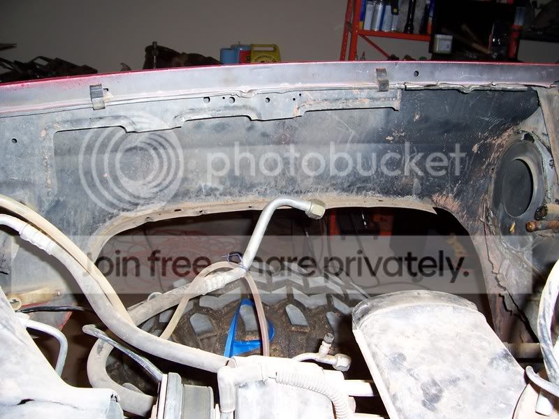

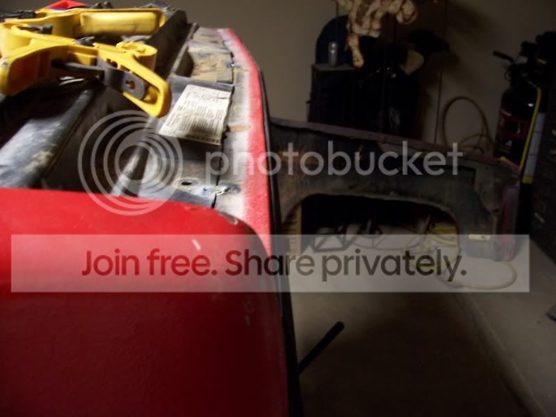

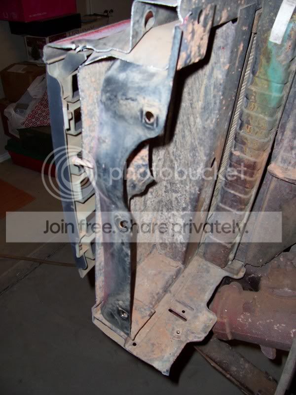

  16. gmc4cw
    gmc4cw 1/2 ton status GMOTM Winner
    Joined:
    Jul 19, 2006
    Posts:
    3,907
    Likes Received:
    Location:
    west chester, Pa

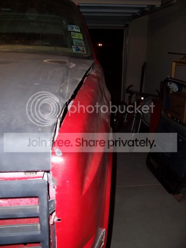

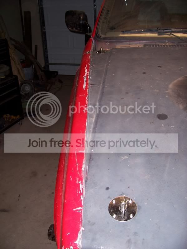

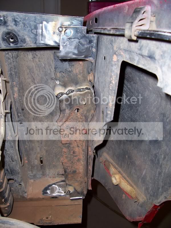

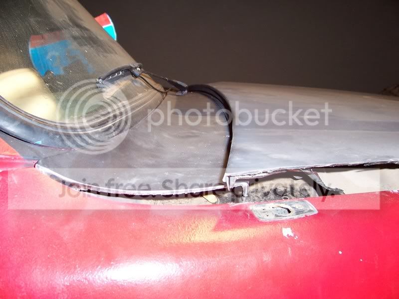

    I would like to see how you bolted the fender to the rad support. also did you skin the fender back by the body or just bend around it. the fenders don't look like they are kinked like the others on here.

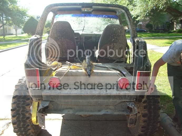

    how much did everyone take out of the back?
    i took 17" from each side of mine then later on took 3" more per side. taillights sat right on top of the frame
    [​IMG]
    [​IMG]

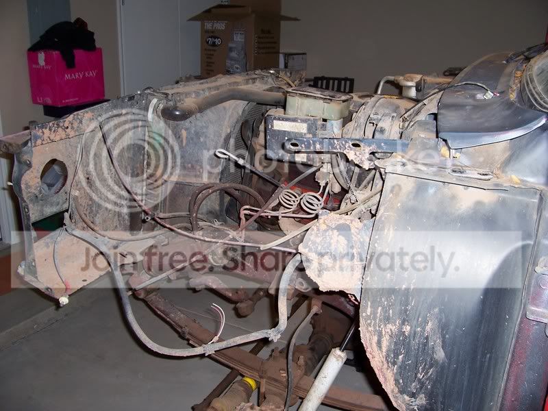

    I used the stock mount for the fenders and cut them to fit.
    [​IMG]
    [​IMG]
    [​IMG]
    As for the fender, I did skin it and angle it in. I wanted to not have the crease in it. I had to take out the blower motor/ac unit.
    [​IMG]

    thanks. :waytogo: those were exactly what I needed to see to proceed with mine. luckily I have an extra rad support to play with.
