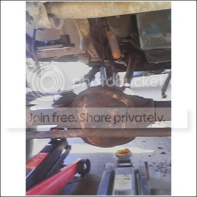

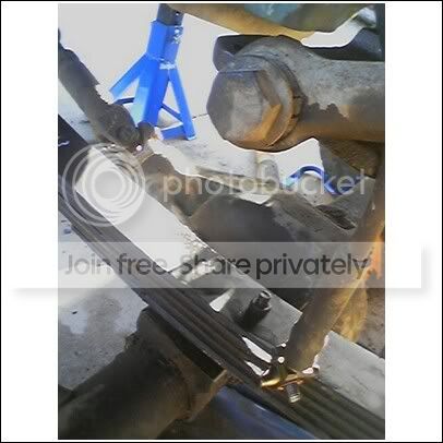

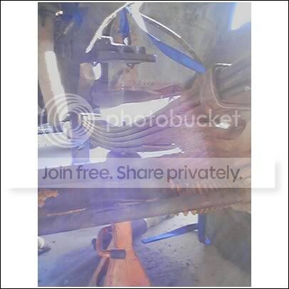

I just went out and took a look at it. I'm uploading pictures now but it seems like everything is off. My diffrential is rotated down and both center pins are off, previously I only had the passenger side not lined up.
New game plan: Disconnect front driveline and push rotate axle forward to line up both sides. I could really use the suggestions guys, thanks again.
