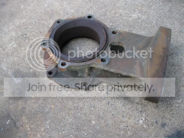

gotblazers 1/2 ton status Joined May 19, 2010 Posts 2,873 Reaction score 5 Location Vermillion,SD Aug 28, 2011 #3 I dont honestly know the difference between tall and short but this is the one i got. It just has 2 bolts going up

thatK30guy 1 ton status Premium Joined Jan 12, 2001 Posts 32,580 Reaction score 541 Location . Aug 28, 2011 #4 Tall adaptors fit the flat crossmembers up to '84. Short adaptors are the '85 to '91 pieces that fit the W-shaped crossmembers.

gotblazers 1/2 ton status Joined May 19, 2010 Posts 2,873 Reaction score 5 Location Vermillion,SD Aug 28, 2011 #5 thatK30guy said: Tall adaptors fit the flat crossmembers up to '84. Short adaptors are the '85 to '91 pieces that fit the W-shaped crossmembers. Click to expand... This is out of an 84 suburban so i guess it would be the tall one.
