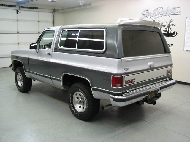

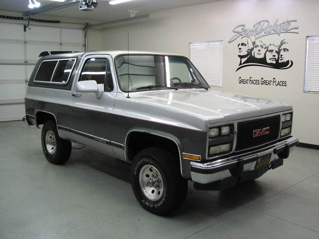

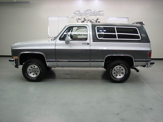

Heres some pics of what I want, please advise me if this is doable.
My Jimmy

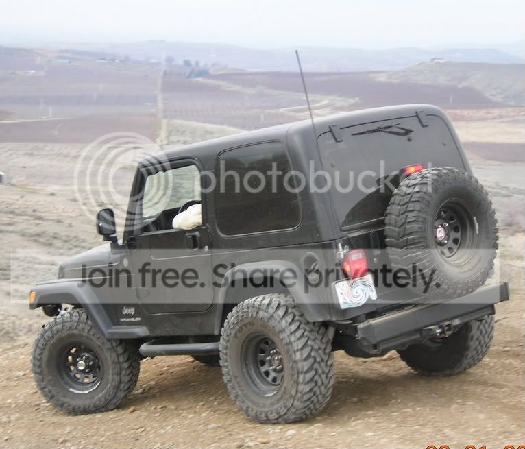

The wheels/look I want (his are 3"BS though with 4" lift)
The tires are 33x13.50x15 Toyo M/T

my guess is the tires on the blue/white rig are 33/12.5 on 10" rim.

it would probably be easier to PM Never Satisfied, who ownes the blue/white rig and ask him what he has and if he has any issues. remember. he has a 4" lift though........
ok...maybe that's why Chevy went with the rally wheel dimensions, because 4" is the max BS you can safely go. the problem i see 88 is you want that real deep look and not hit the fenders. just limit your bumpstops and pray :D
I talked to him allready, He has just the 4" lift, 15x10 with only 3" of backspacing with 33x12.50 and has no rubbing, not even flexing light offroad according to him, I figured since mine would be 4" backspacing (tucked in another inch I could pull it off).

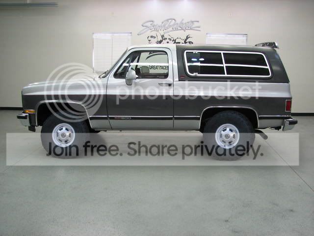

quick photoshop
These tires do ballon out on a 10" wide wheel so I will go with the poll vote on buy 8" wide to play it safe.
Heres the 33x13.50 on 15x10's, looks like the tread width isnt as wide as I thought and Im not digging the ballon look. Im still gonna get the 13.50 but mount them on the 8" wide wheel.
