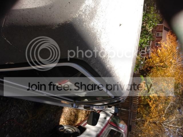

P.S. I'll keep you posted on the stuff if you like and there is a pic on one of the two threads I started. I can't post pics. All I have is an old flip phone.
Disenough, I thought that was the case, but I didn't want to impose on you. I was going to try to get my daughter to help me, but my grandaughter is sick, so it'll be a couple/few days until I can even hope to get her.
I got 1 that I think he will be able to see the problem. Thanks, Paul

Ryoken, Disenough, The weather eased off today so I was able to get some done. I removed the paper towels with the E-Rust, washed to off and sanded the metal between the grill and the radiator. Let it dry then put 2 light/med coats of some flat high temp primer on it. I lightly scuffed it between coats. It looks good. I'll go over it with 2 coats of gloss black next.
On the edge of the doors the paint is chipped off but, the primer is intact. Can I sand the edge of the silver down to smooth with the primer and respray the edge with the silver lightly 2 or three coats then polish the paint down to blend it into the old paint. I plan on using some clear coat on it and can I do it the same way? I don't think that the silver has faded much. The Dura-coat paint is supposed to match but I doubt that it's going to be perfect.

Now with that out of the way, They are calling for rain starting in the next couple of days. I thought that I'd be better off to prime the sanded and chemically de-rusted areas. I saw an area on the roof above the door that looked like it should be touched up with sandpaper. The place didn't seem to be improving so I took my knife and lightly "probed" the paint edge. The paint (Silver) started coming off in pieces that hadn't adhered to the primer. I got 1 that was 1" wide and 3" long. I shot some primer under the paint's edge to try to keep any rain out. The factory primer seems real smooth, no texture at all. It's a little shiny.
I know that the whole top needs to be sanded down to a layer of primer (paint) that is adheared. If I get to an area of the paint that is adheered rather than just scuffing the paint for new primer, I need to get to the primer layer at least, then sand it and reprime the whole roof, right? I guess this is why I see alot of white and silver GM vehicles with paint problems.
Since the primer has some problem but, so far is stuck to the metal real well, if I sand it and use the adhesion improving primer, I wouldn't have to go to bare metal, would I?
This is getting to be more than I expected. Tell me the minimum that I can do and still not have to worry about the paint coming off again. I'm leary of leaving any silver on the roof even if it is stuck down now.
