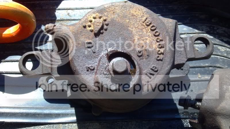

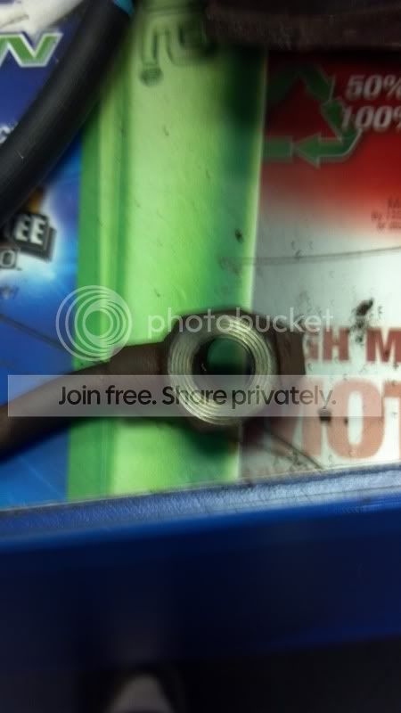

Calipers I'm trying to use came off a 79 3/4 ton. They are going on a 3/4 axels under my 1989 k5 with 6"lift of lift. I've heard people run the 2wd brake lines for extra length. In my case the 2wd lines have a diffent flange......or at least all the the ones I've found. So I'm trying to find what year / model truck would run the flange pictured and be long enough to accommodate my lift?
Any help would be appreciated!
Here is the flange I'm trying to match
Ill have to check into those. Was the part number you posted the correct part number? The other end screws into the brake line alright? Meaning it had 3/8 end?
Thank you I'm so tired of going to parts stores
just pulled them up on napa, they sure dont look the same......
Yep, that's the one. That is a picture of the bolt with a cap on it.
I don't think it will work on that caliper. The caliper area is round and the hose end is squared. You would have to file or grind a little on the caliper area.
I haven't messed with my '85 D60 yet. BUT my 14b disc conversion and my old '78 D44 8 lug 3/4 ton front used the square fitting.
Well Napa couldn't even order the dodge 4x4 ones so I ended up buying some 2wd lines and gona trim.them up to fit in the calipers
