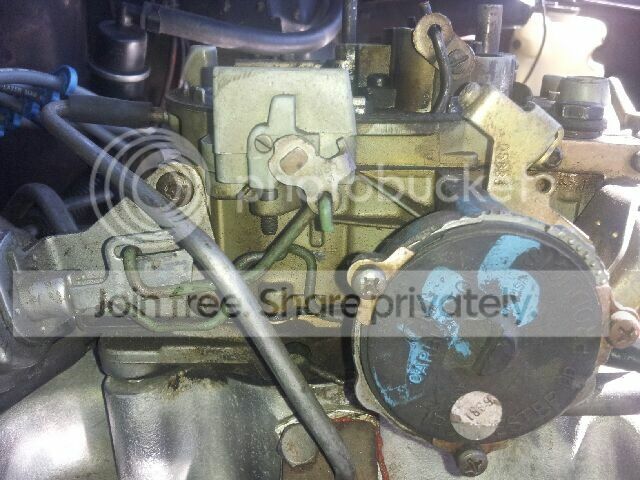

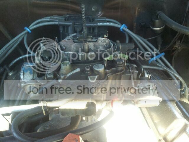

To replace the Edelbrock on my 78. I would do an electric choke swap on it and a full rebuild. Supposedly a 77 350 unit. What do you think? Look good? Hard to read the numbers.

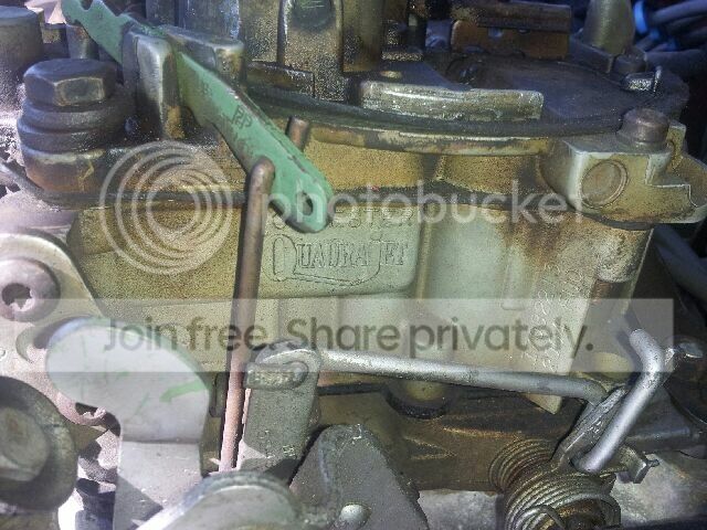

first pic . back face run those stamped in casting #'s for exact break down info .
and from what I have read and been told don't touch the secondary air door spring setting screw thingy .
17082213 is the carb #..
Google search shows its off an '82 chevy 350...truck probably,unless its the electric feedback style carb,then it'd be off a car..
I'm not scared to adjust the air valve spring on a Q-jet,it can be tricky to set it just right,but not impossible to do...you never know if its been messed with already too!..
Im good at tuning that spring. Thanks For clearing up the carb number! It was hard for me to see! I'll do some more research on it.

17082=1982, 2=federal emissions, 1=Chevy,
3= standard shift but not always. If u need the kickdown
For the trans make sure it has the correct linkage.
