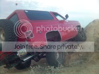

My plan is to keep this K5 looking good and play with my other one. Looking for ideas and pics from other peoples custom jobs.

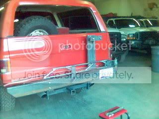

I saw the ones from blazingoffroad, but noe what I'm looking for, I guess Im needing to know how most people locked the gate as it closed and the where it swings
Here was the org. design.
I wanted to add a gas can carrier
Inside shot
I don't think i remember seeing the hinge listed on his website but if you PM him he can give you a price.
Most all swing out tire carriers use Trailer hubs for a hinge. Easy to replace and find parts for. Makes cost low too.
However,
Our spindle is somewhat different than what you would pick up at the local farm and fleet store. The off the shelf spindles have a significant short coming.
Our hub is not a trailer piece either. It's a Chunk of DOM tubing bored out for race seats.
just an FYI.
