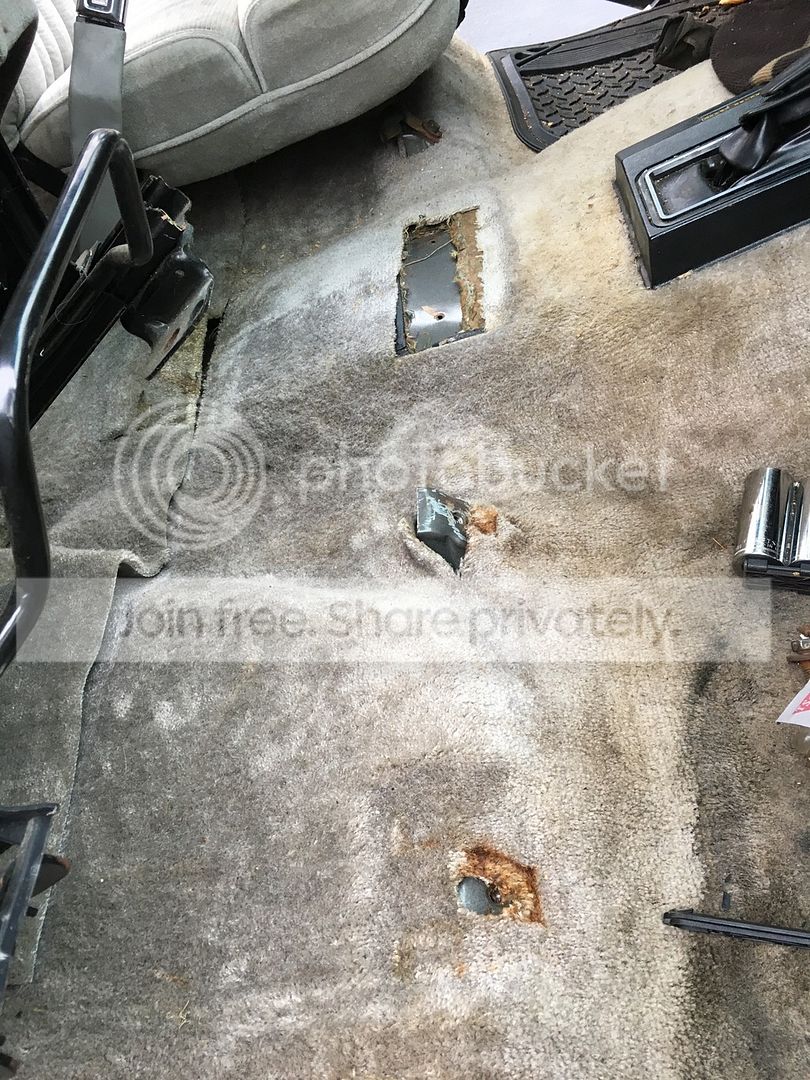

I'm going to pull the tracks off of seats this weekend and see if old tracks suburban tracks will lower Silverado seats any. I can fab up brackets to align bolt holes if they lower seats enough. Otherwise, I'll sell Silverado seats and grab some seats out of a Cruze. I liked those in the one I had

I'll definitely let you know what I figure out. I can't find much online for humpy floored Suburbans. I'm going to pull passenger seat out and hit a couple junk yards. Hopefully they will let me test fit and eyeball before I buy anything. Otherwise, I'll be tape measure fitting

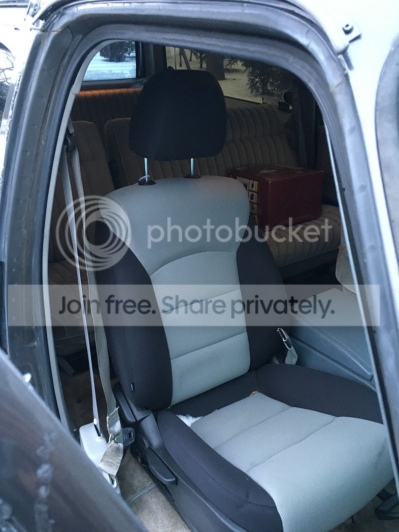

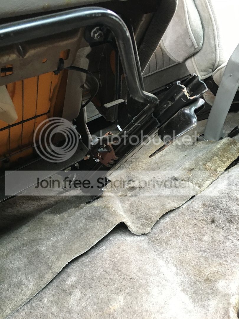

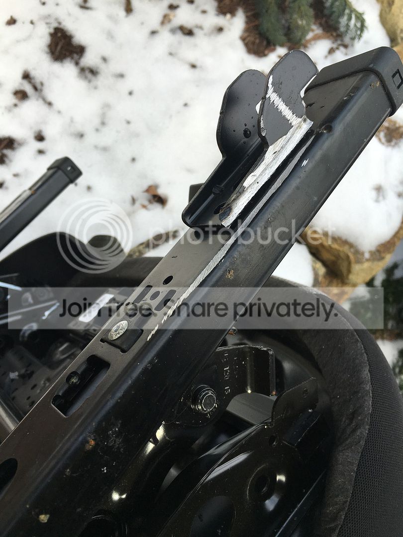

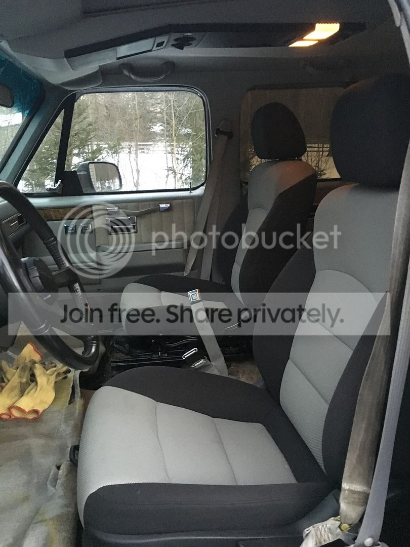

I got a plan(famous last words right there). I spent about 4 hours walking around 2 different junk yards Monday and I think these will work. They are from a Chevy Cruze. I sat in 09-12 Malibu and 07-13 Impala seats and they also seemed like they could work. I picked the Cruze seats because they have a lever that raises and lowers the seats several inches and I work at the plant that makes the Cruze. Looks like a pretty easy install. I'll have to fab up a bracket for one corner,but I was going to have to do that with anything. May try install this weekend if it warms up a little. Here's a couple pics of one just sitting in place..

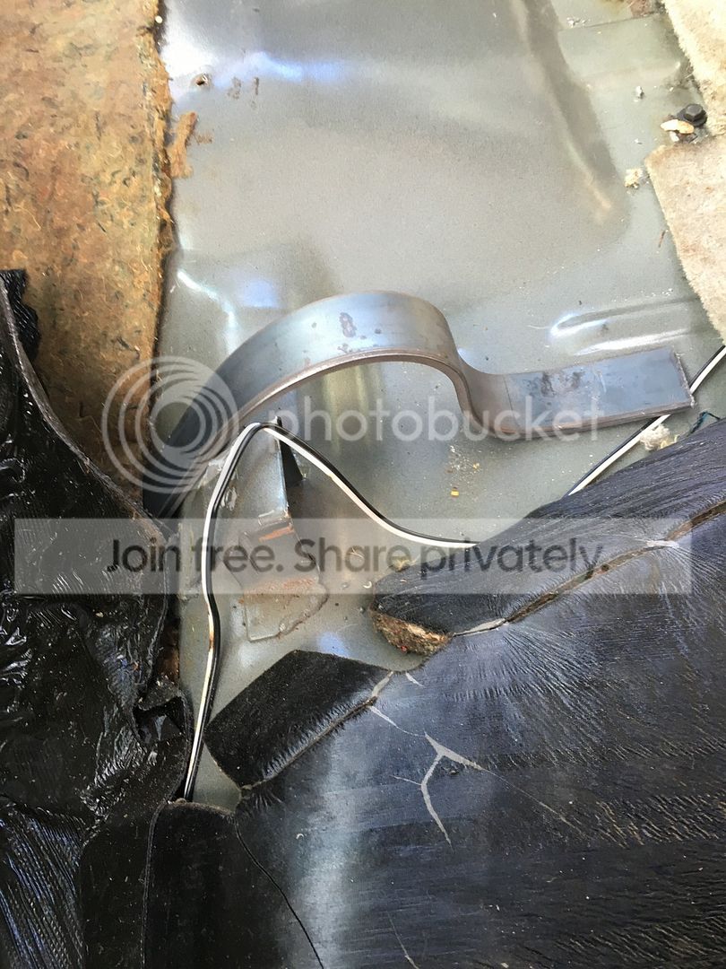

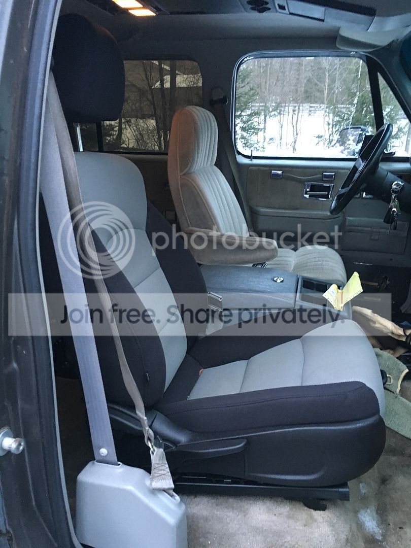

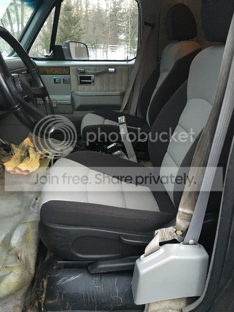

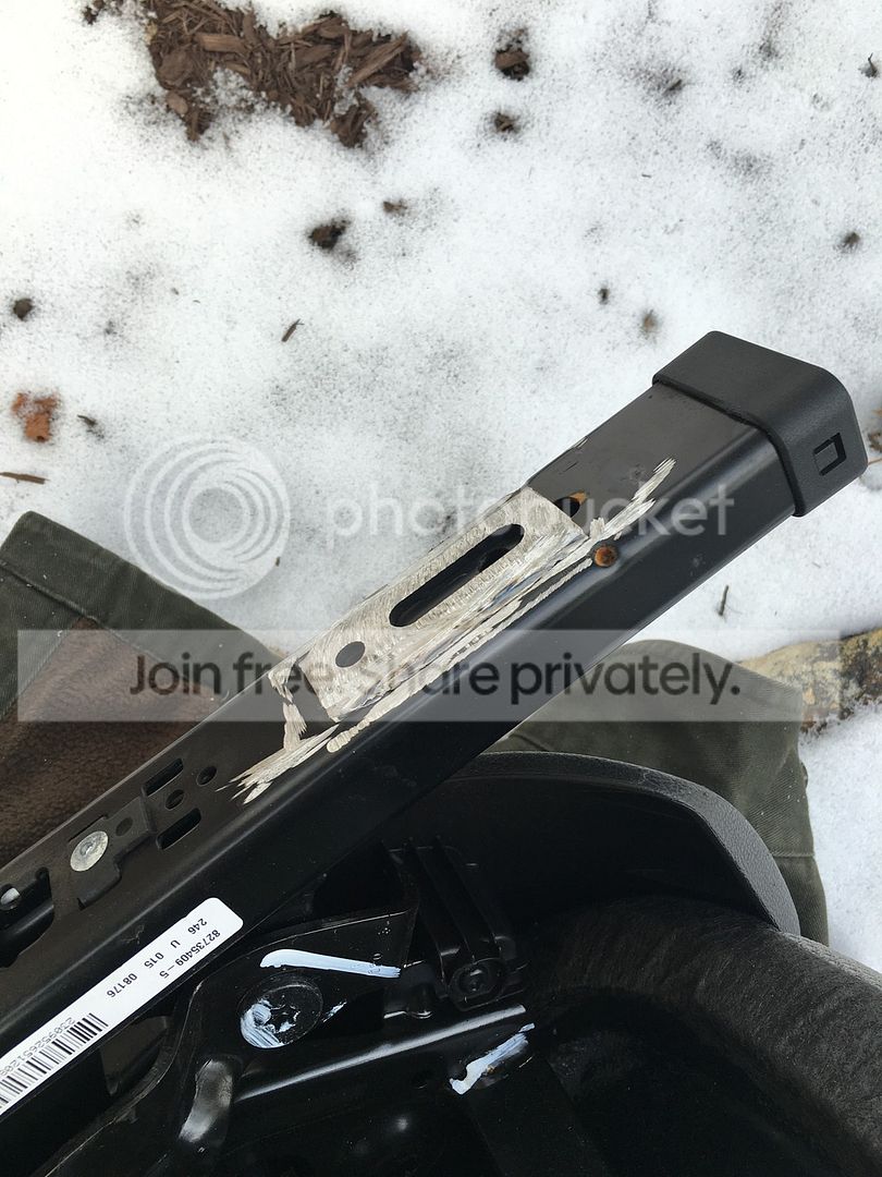

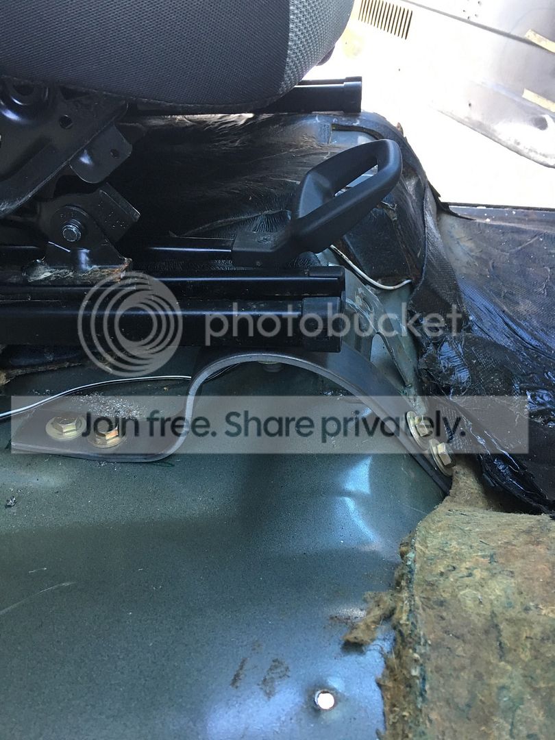

Got the Cruze seats loosely installed today. I had to make a bracket for each inside front corner and use spacers in the rear to level things out. It was a pretty straight forward install. I may start fitting the console tomorrow if weather permits
I'm pleased with the outcome. They slide way further back than the factory seats. The manual height adjusters are great too. I used 1 1/2x 1/4 flat stock to make brackets and all grade 8 hardware with nylon lock nuts.
