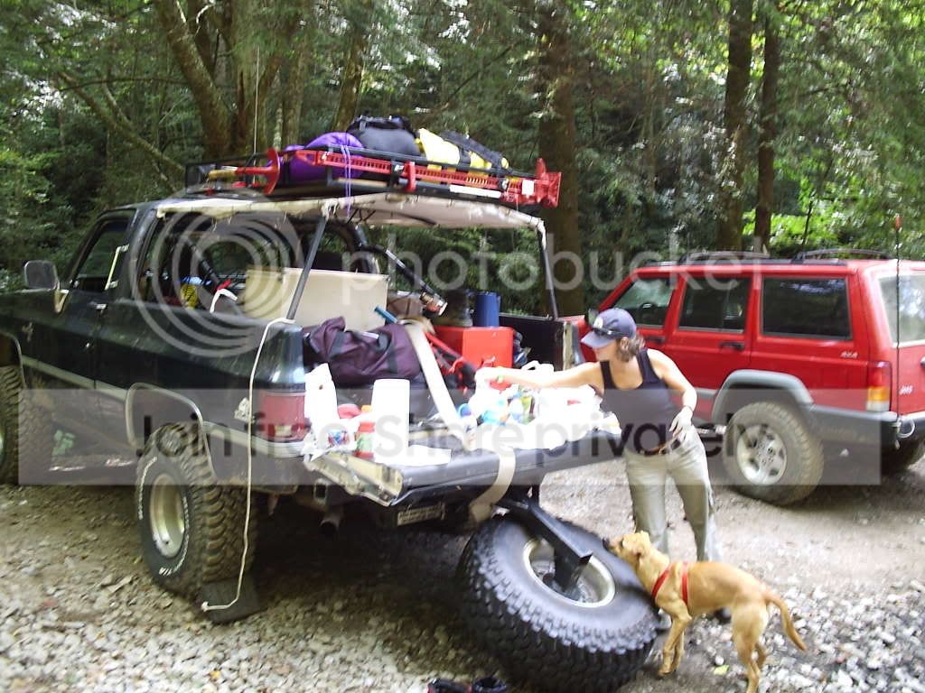

big ammo can, 4 bolts, 2 u-bolts, 2 pad locks and some drilled holes. Presto, locking, water proof, secure storage. Doesn't take up much tub-space either. The ones I used to run (and will again when the body mods are done...) are about 8" wide, 20" long and 20" tall. Pretty sure I have a better pic in webshots, but here is a so-so one...
I don't run a rear seat... but the same boxes mounted a foot further to the rear would allow for a rear seat and be easier to access from the rear end too.
