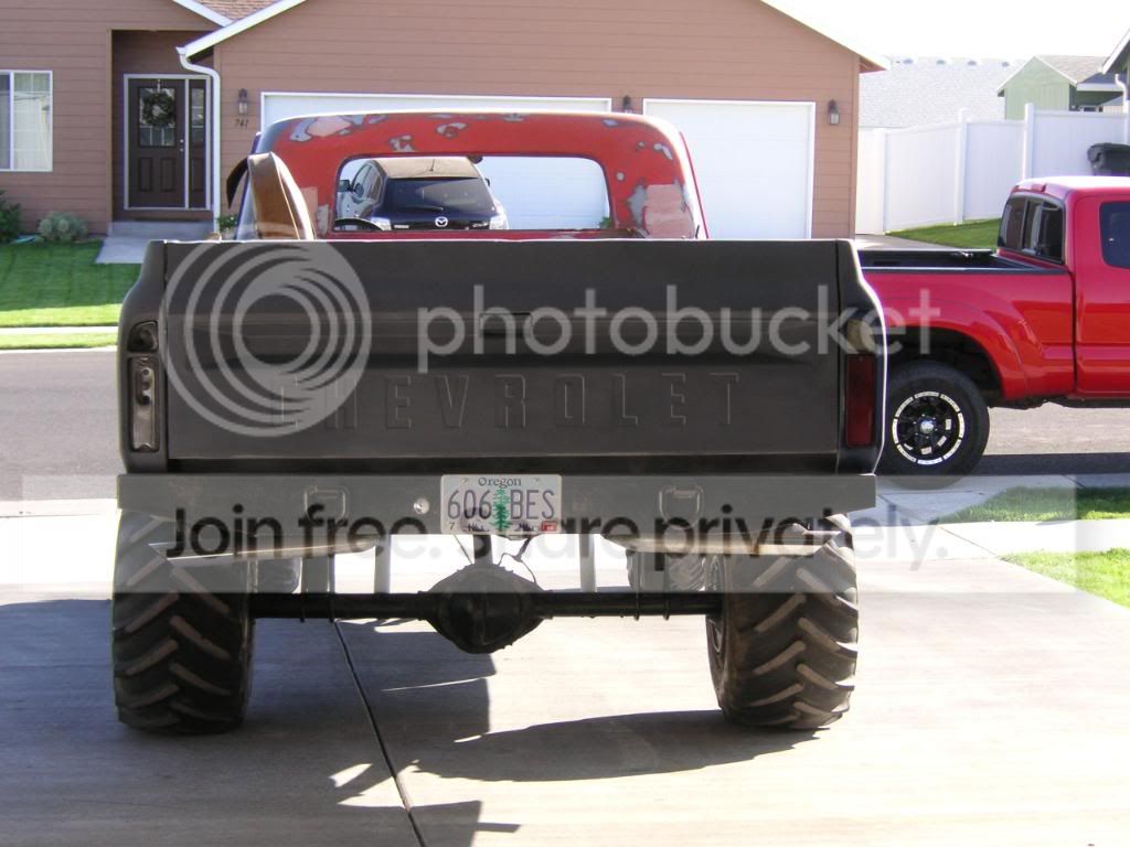

I am looking for some myself for my '71. I am looking for some pretty much like these:

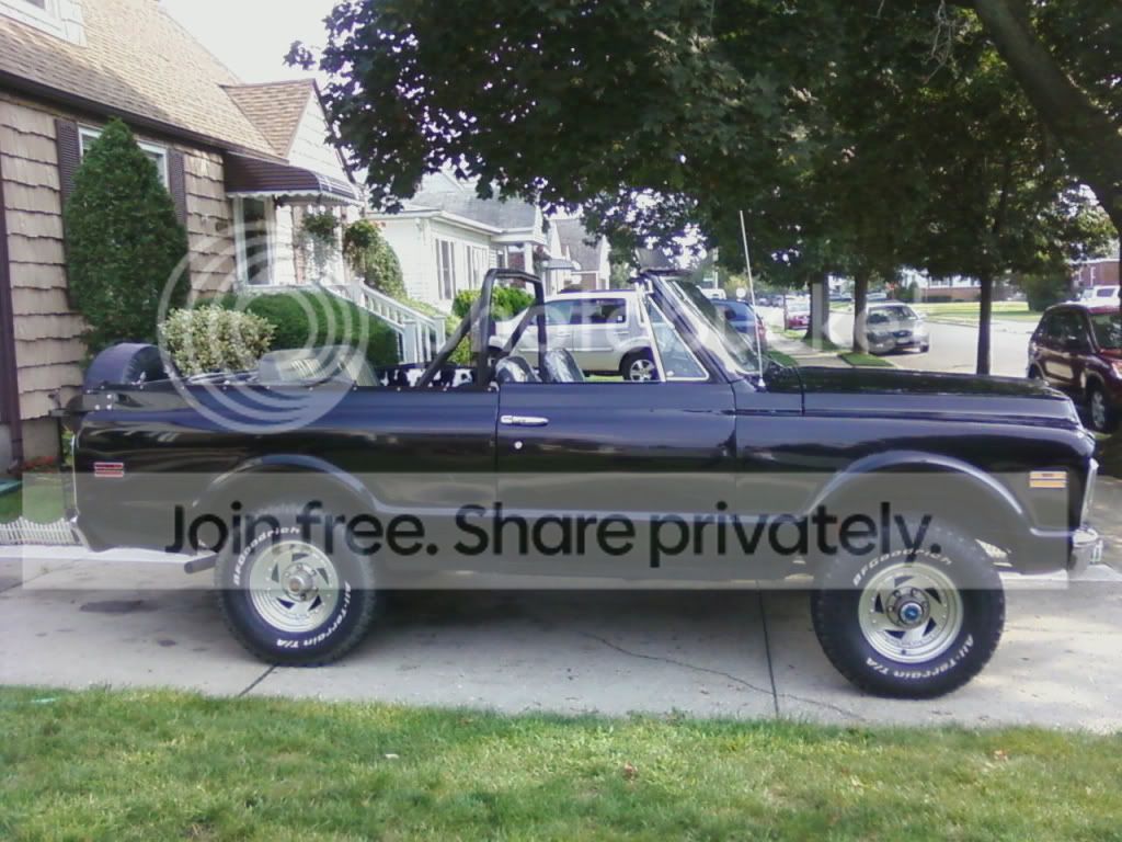

I can't find anywhere that makes them for '67 - '72 series. Can anyone advise if they are available anywhere? Here is my new ride that I got at the Carlisle truck show yesterday

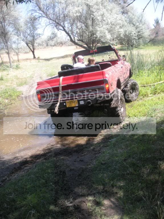

Here are mine, bumpers custom built by a shop no longer in business but diy makes similar and hella strong.
