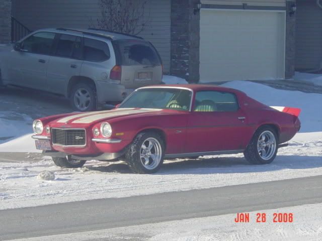

whats your plans for this vehicle? i'd love to have it...my favorite body style other than a 69.
1971 Camaro RS
needs split front bumper & a bbc/th400 & it would be my dream car!
70-73 RS is a split bumper. It will be a family cruiser really. I have been wanting a 78ish corvette for years a realized I would rather have a car that the whole family can get it, go to car shows, burgers/icecream etc. Basically I am going to restomod the car with good paint, wheels, 4th gen firebird interior. The engine is still a slight toss up, either going to be a 6.2 diesel and 700R4 or a 5.3/4l60E. I am REALLY leaning towards the 6.2 just to be different. This will be for cruising so I don't really need lots of power I just think the 6.2 would be really cool.
my '73 RS-z-28
just right. '70.5 - '73 with Rally Sport package. split bumper with round signal lights

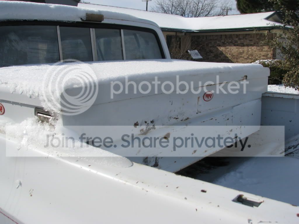

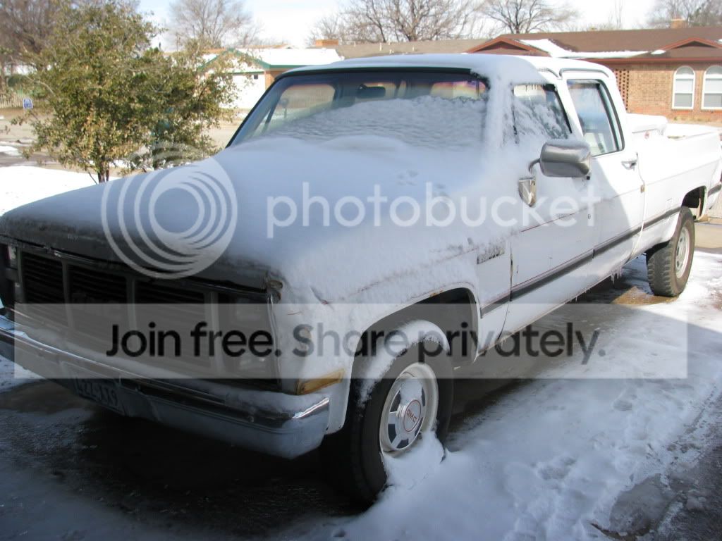

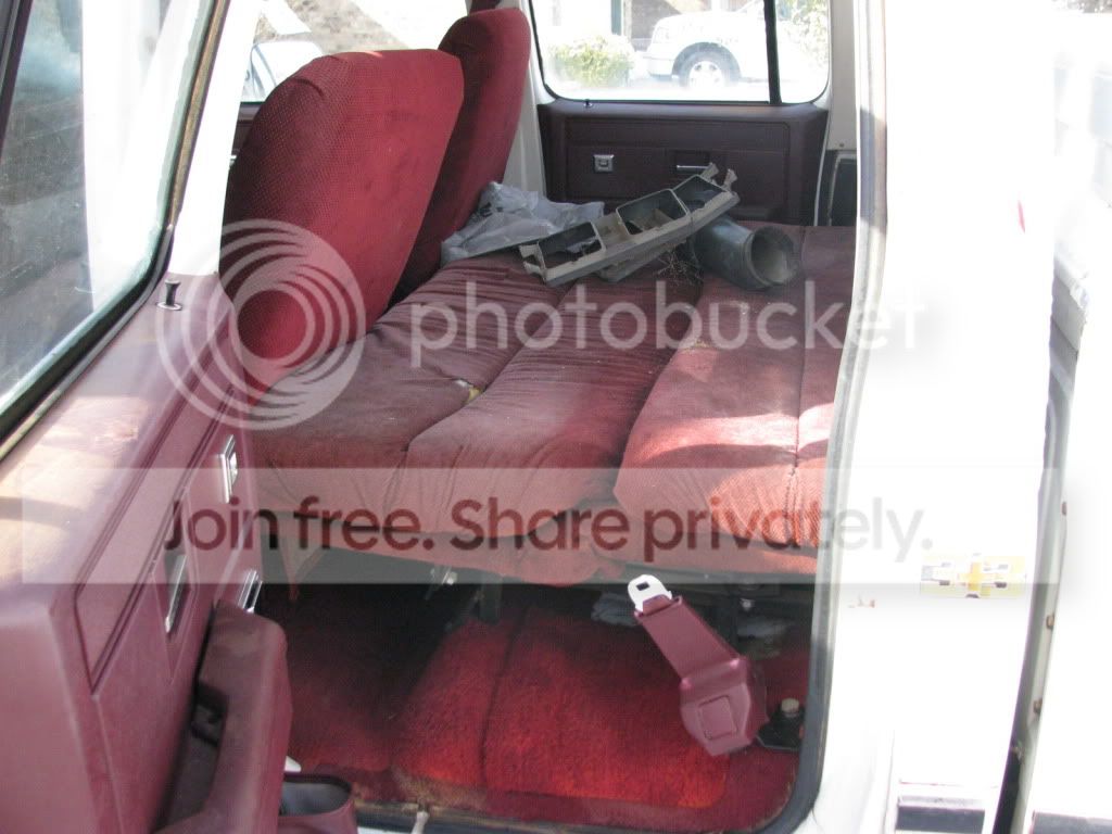

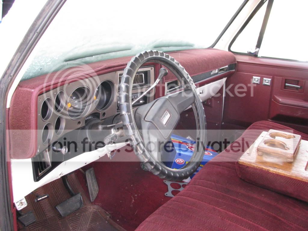

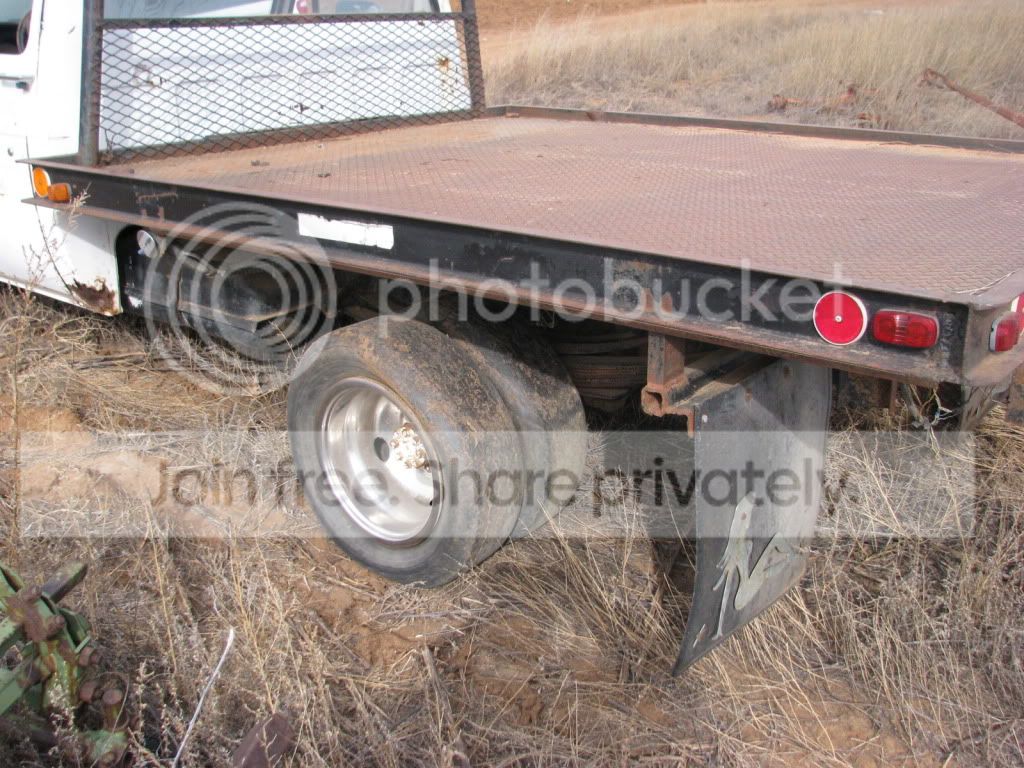

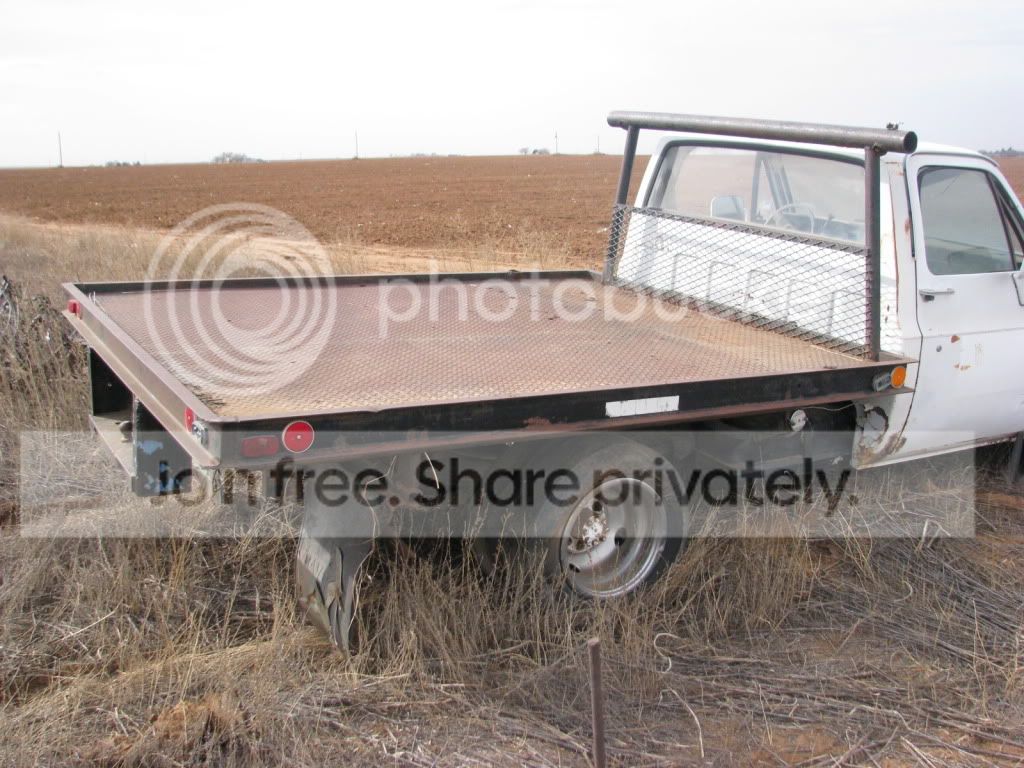

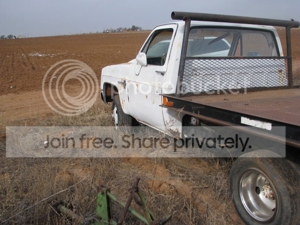

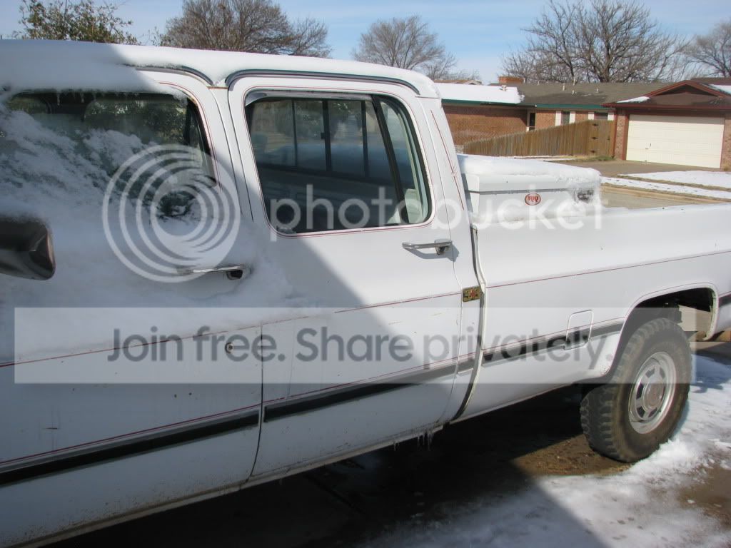

Well since I only have the crewcab here to take pics of and I haven't posted any here you go. I am calling it the "Craigslist Beast", so far everything for this project has come from craigslist. That includes the crewcab, C&C flatbed dually, diesel 1 ton, and the RKI tool box on the back of the crewcab.

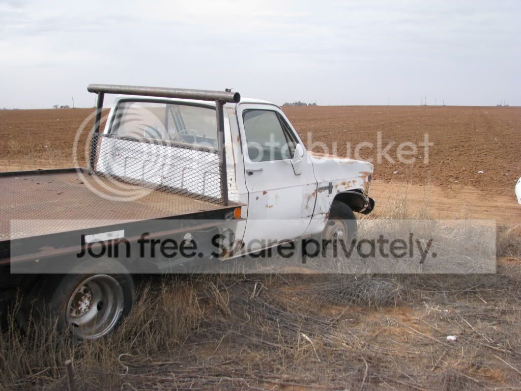

Oh and I forgot I had some pics of the dually so here they are.
