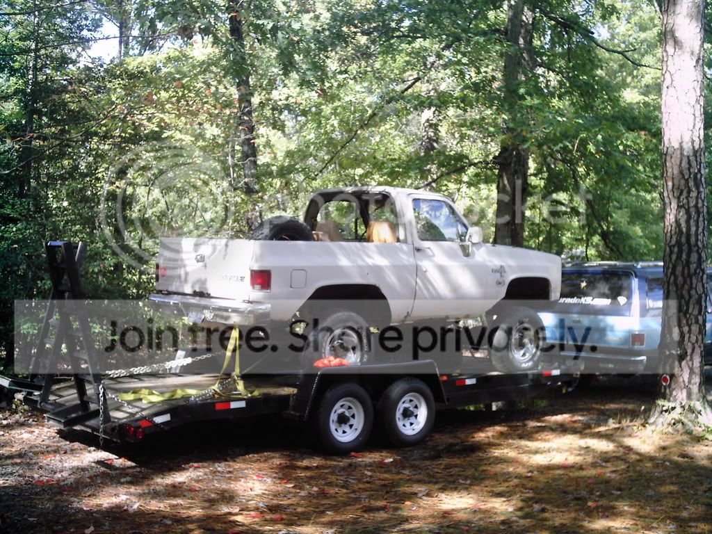

basically the truck needs to sit about 2 feet farther foward than it is in the pc...im thinking im gonna have to always change the rear tires and that sucks

I am still curious about the Suburban. Tires, lift, 3/4 or 1/2 ton? Creating a crap load of tongue weight is a band aid (and potentially dangerous) for the real problem. You only need 10-15% tongue weight, and loaded the way it is in the picture should be fine for that (unless like I said yesterday, there is a lot of weight in the back of the Blazer).

here is how it sat on the trailer when it pulled so well coming home...
Crap dude...thats really far forward...

IMO, way more tongue weight then you need. You practically have a whole Blazer on a hitch probably rated for maybe 750 lbs. of weight (1,000 lbs. at the most, and usually only with weight distributing hitch).

well Jamie, you are right. after seeing the pics. you don't have enough tongue weight with the rear boggers on. the axles on your trailer are about centered. I bet empty the trailer pulls like crap over 55mph.
