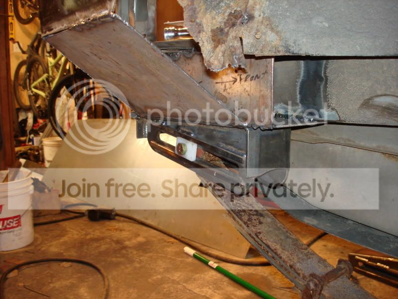

Has anyone tried these spring sliders? They seem like a great Idea, I might try a set.
I wouldn't waste time with those sliders.

And it works real well when it's new. Throw some mud, sand and road crap into it, and I see binding issues.
