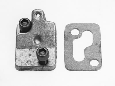

In your top picture, that rectangular metal plate with the metal line coming out of it that goes to nowhere, that is where the remote choke spring is suppose to be.
The intake should have a coil spring that attaches to the intake manifold where you have that metal plate that leads to nowhere. It operates by engine temp and when it gets hot the spring coil opens your choke , THATS WHY IT IS MANUL CHOKE. As far as the cross over I do beleive that it is what you have plugged off. It is the metal tube that is comining out from the middle of the intake. Srry for caps I am is a rush and dont have time to retype. I am no carb God for the record...You can bypass that style of choke and put and "in cab" pull style manul choke setup. They are cheap and easy to install. Just drill a hole in your dash that is easyily acessible and then route it through your passenger firewall with no kinks or bends and connect it to your carb. It is a cable set-up.
I'm no QJet god, but you have the wrong kind of intake for that carb, or the wrong carb for that intake.
The intake is set up for a hot air choke ... to wit:

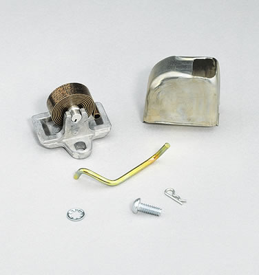

And your carb is set up for a divorced choke, which should have the little coil sitting on top of the metal plate that has the pipe in it right now.
You could convert to the divorced choke easy enough; get you a choke plate, bolt it in place of that pipe-plate, and then hang a rod from it:
http://store.summitracing.com/partdetail.asp?autofilter=1&part=EDL-8901&N=700+115&autoview=sku
http://store.summitracing.com/partdetail.asp?autofilter=1&part=EDL%2D1931&N=700+115&autoview=sku
Or you can do the throttle cable thing ... but the karmatically *correct* way is to do it right ;)
-- A
