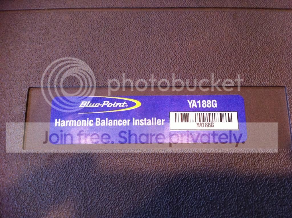

Yeah it spun out easily atleast. Funny thing was it still wet on a quarter inch after I tightened the bolt down. I thought it broke cause it was bottomed :doah:
Borrowed this from my buddy, he just got it 2 days ago,I was the first one to use it!
Worked like a charm! :thumb:
