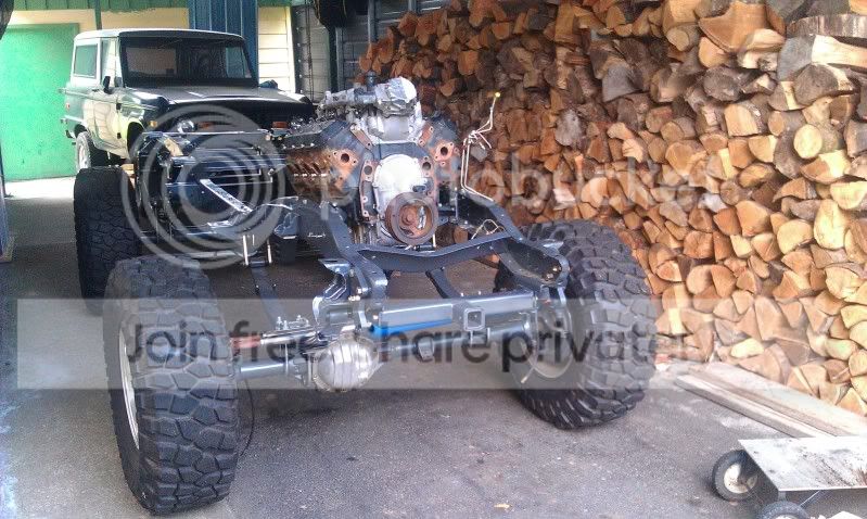

Your 8.1 looks good! Good job! I got mine sitting in the frame - but a ways to go still...
