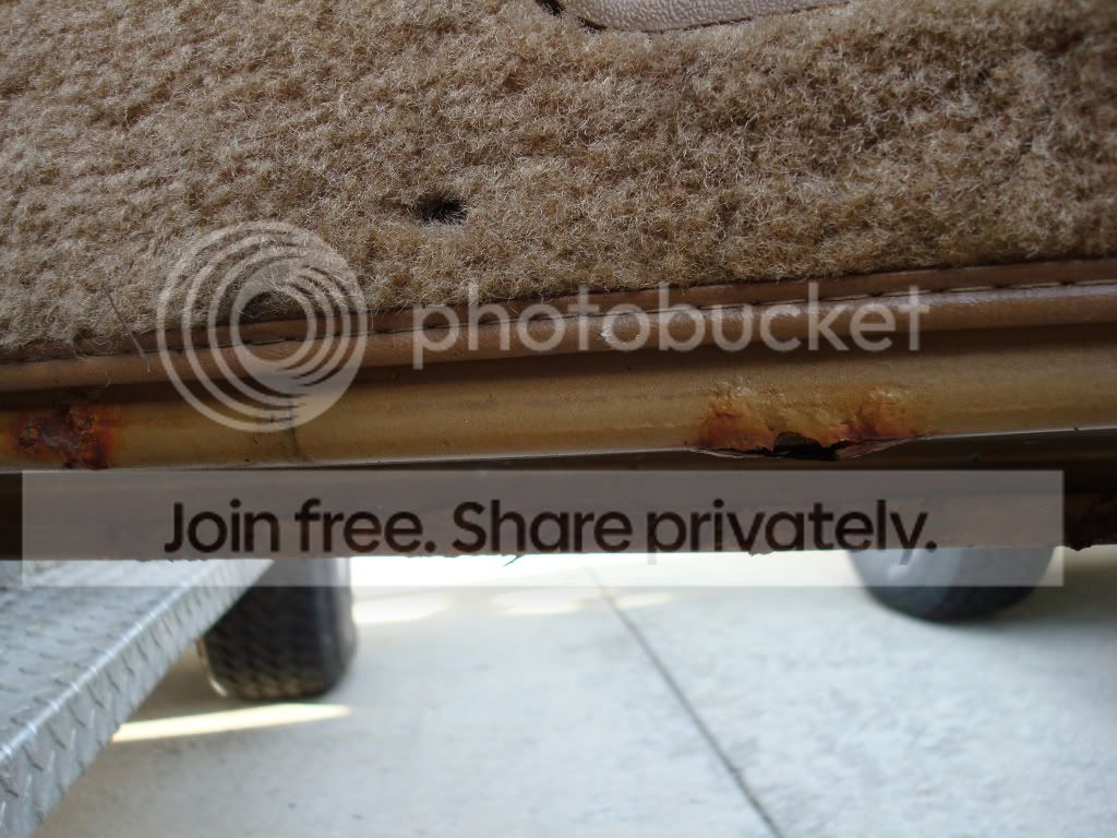

Surprisingly there is only a marginal amount of rust bubbles, no cancer that I've found yet but I haven't pulled the carpet back so we'll see. The interior fared the weather pretty well but there is a bit of mildew on the plastic surfaces and the headliner is completely shot.

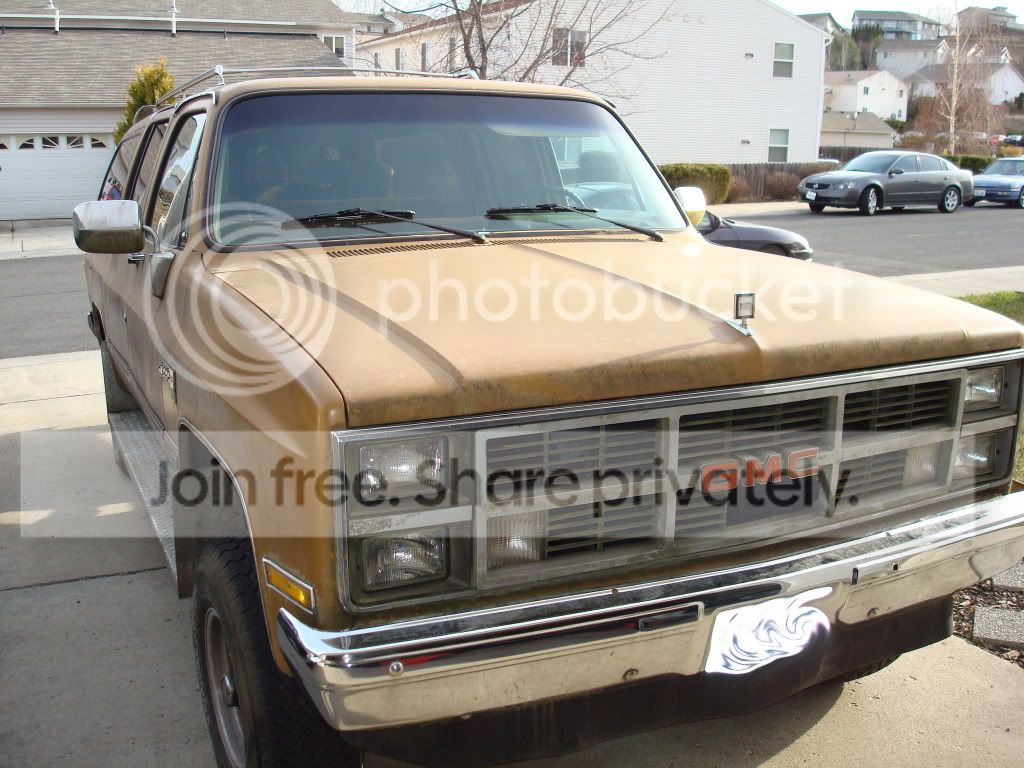

Pics

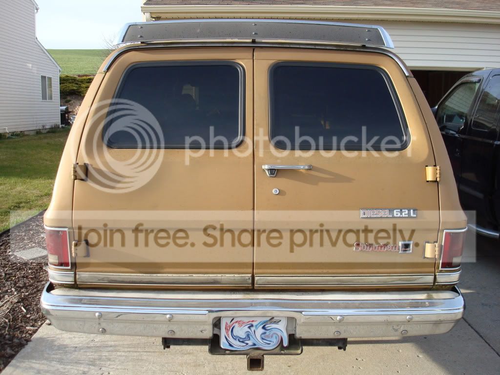

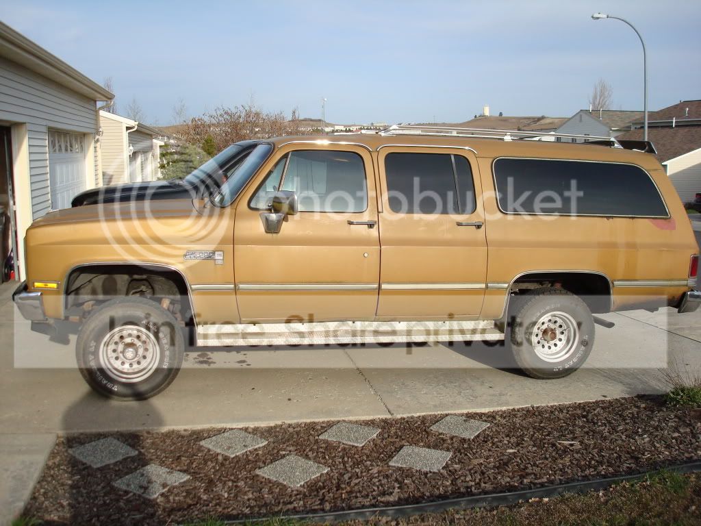

Here's the beast. As you can see the tranny is leaking a little.

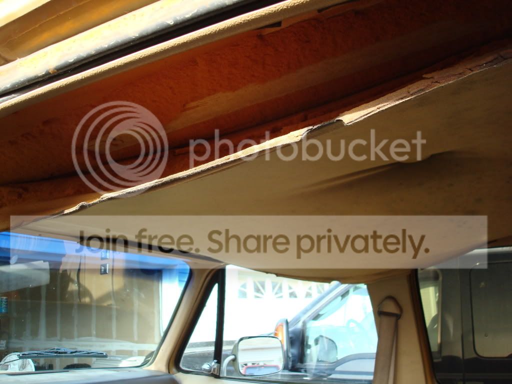

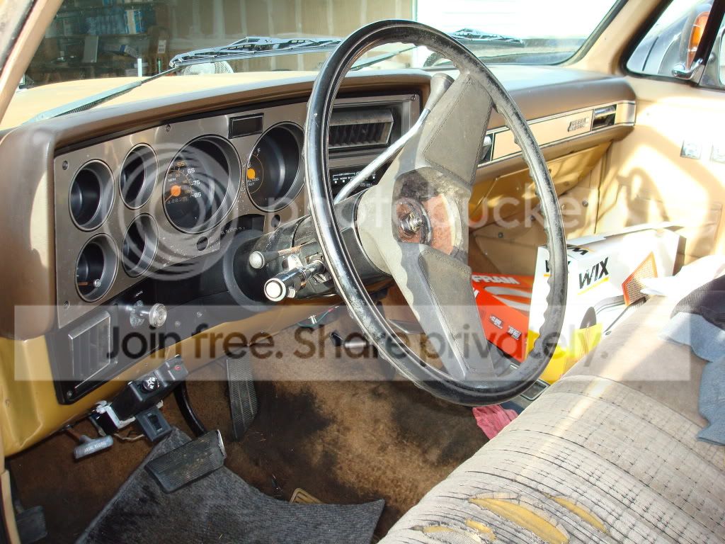

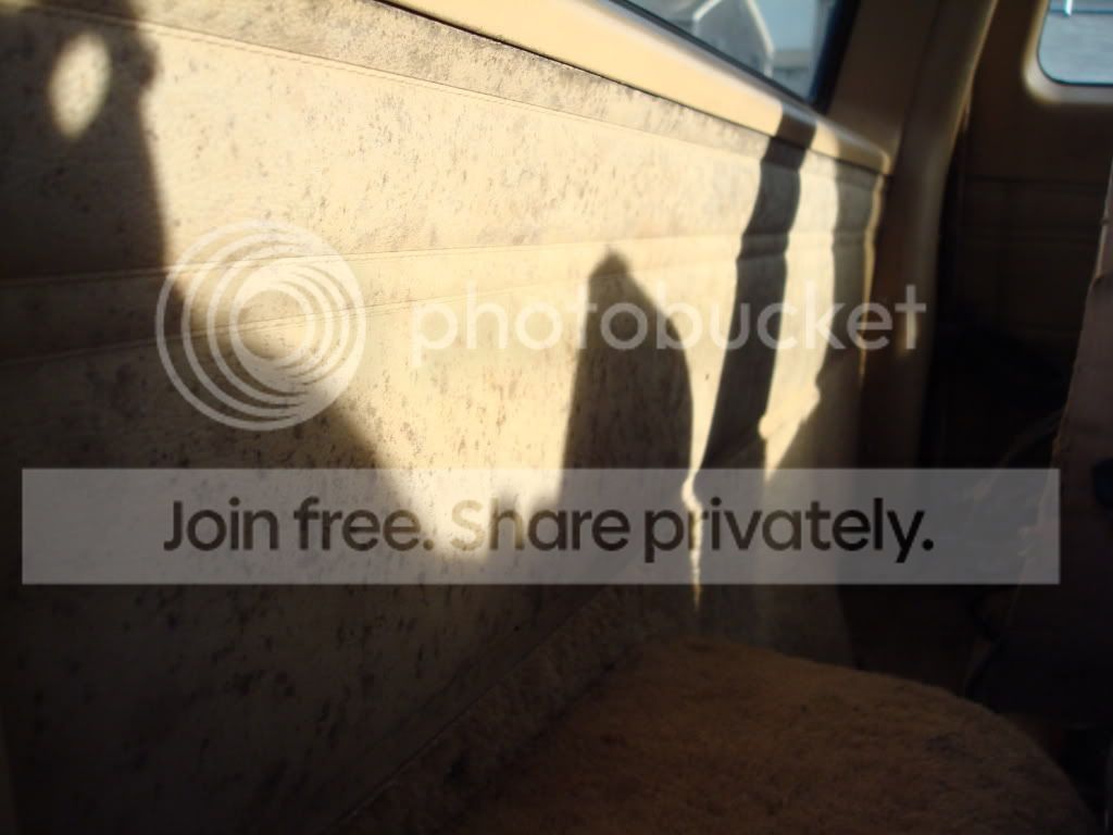

Interior. You can see some of the mildew in the last one.

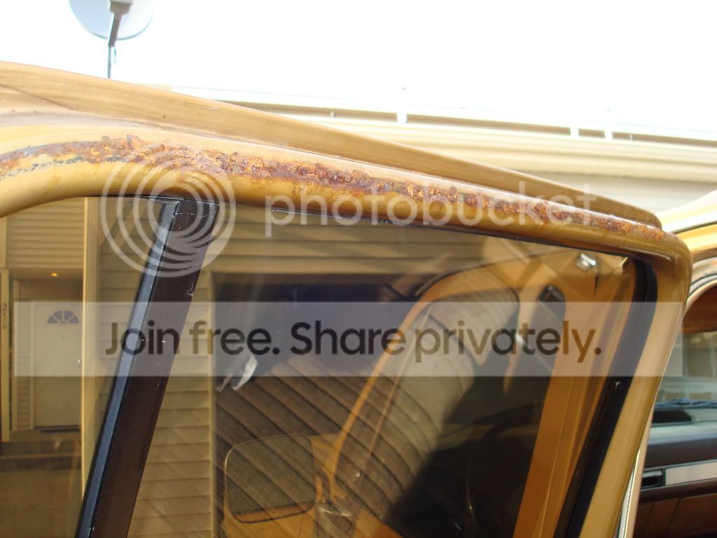

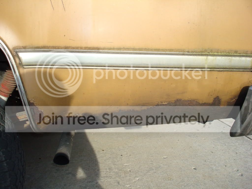

A few rusty spots.

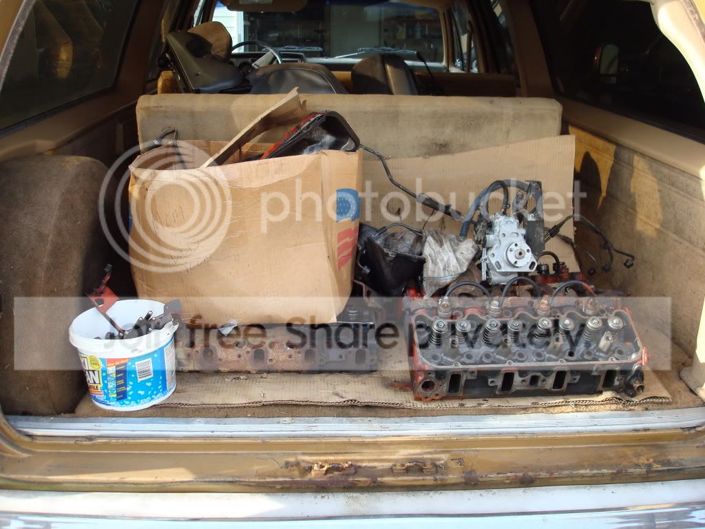

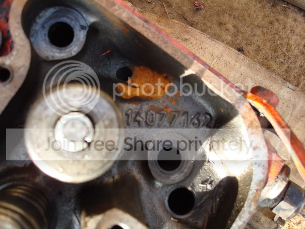

A little surprise. Opened up the back and found some goodies. Two sets of heads, an injection pump, misc push rods/valvetrain stuff, valve covers and an intake manifold. Is that a dual-plane j-code?

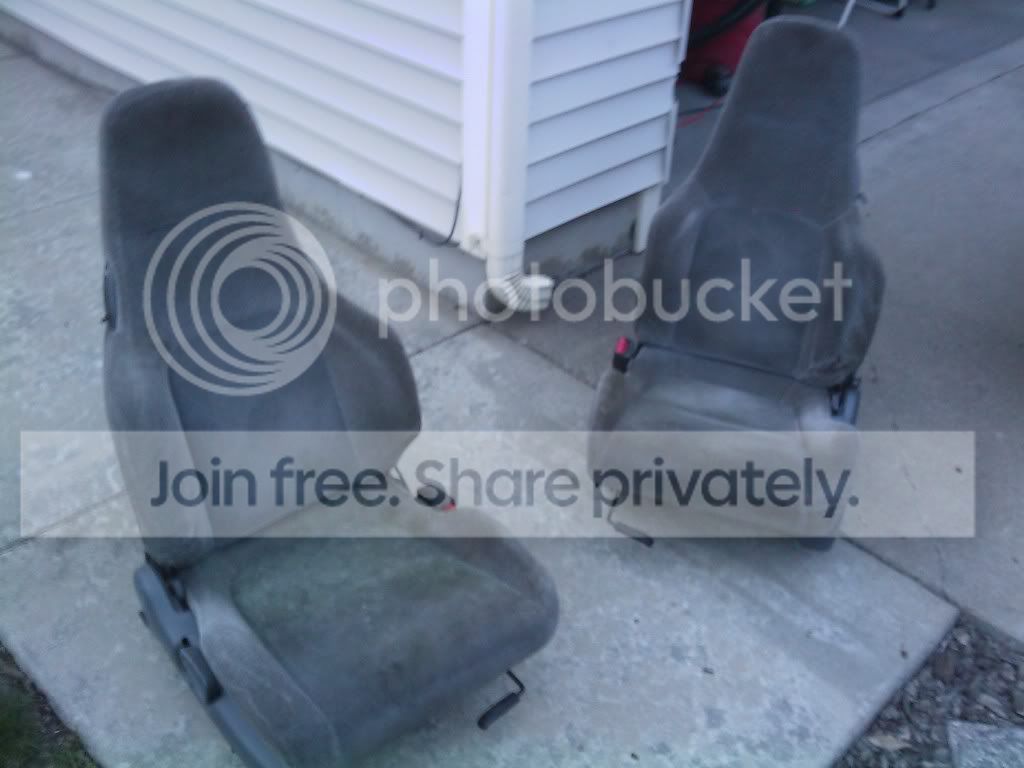

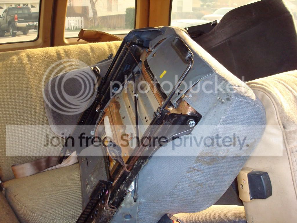

There was a random pair of seats in the back that have seen better days...not sure what they're from.

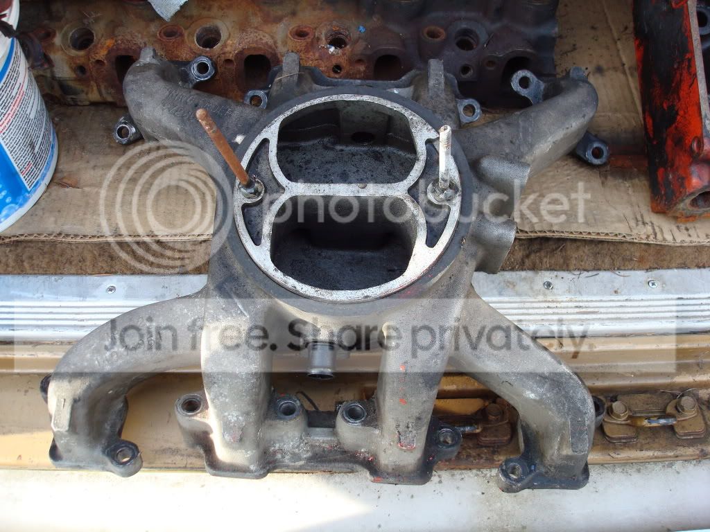

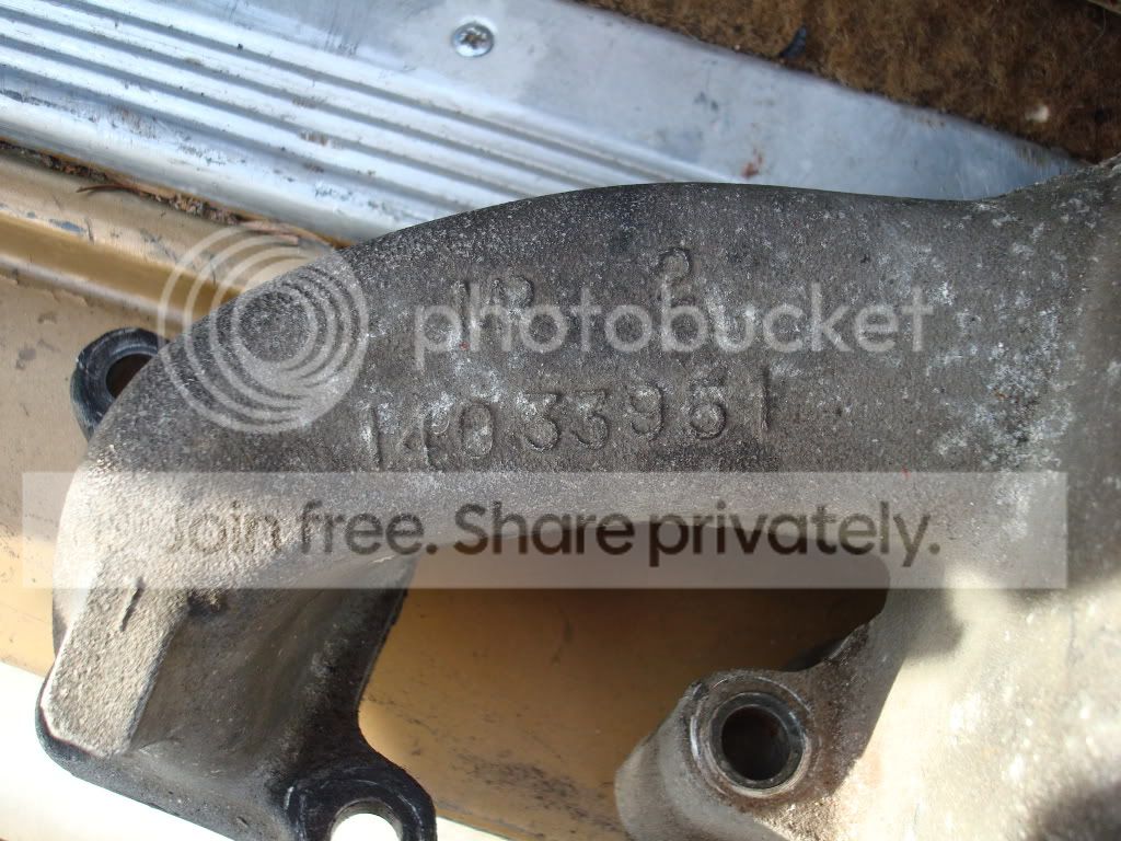

Yup, that's a 'J' code dual plane intake. Something i did that i felt helped quite a bit with my 'J' code was this: i used the new gasket set to "gasket match" the intake ports.
First I laid the new gaskets on the heads and found they gasket and head ports matched really good. Next I laid the same gaskets on the intake and was stunned at how poor the factory intake casting was in comparison to the gasket. There were quite a few ports that were over 1/4" smaller than the gasket. I scribed the areas that need opening up, and using a aluminum specific carbide burr on a die grinder i opened up the intake ports...then blended back into the port to blend and polish. I also blended and knife edged the upper section. The right foot dyno said "success".
Next thing is find out what gearing you have. Most 1/2 tons got sh!t gearing for economy reasons, which can make even a decent running 6.2 seem much worse than it really is.
The low down on 6.2 stuff: max fuel economy, aim for 1800 rpm at 65 mph. Whatever gears/tires you need to get that will work. Approximately every 100 rpm above that magic number will lose you 1 mpg on the highway, but will gain you power. How much you're willing to give up on the economy side of things is up to you of course. Unfortunately the 'burb is a bit of a heavy pig, so you might want to give up a little more economy for the sake of power than someone else might in a pick-up or K5.
Rene

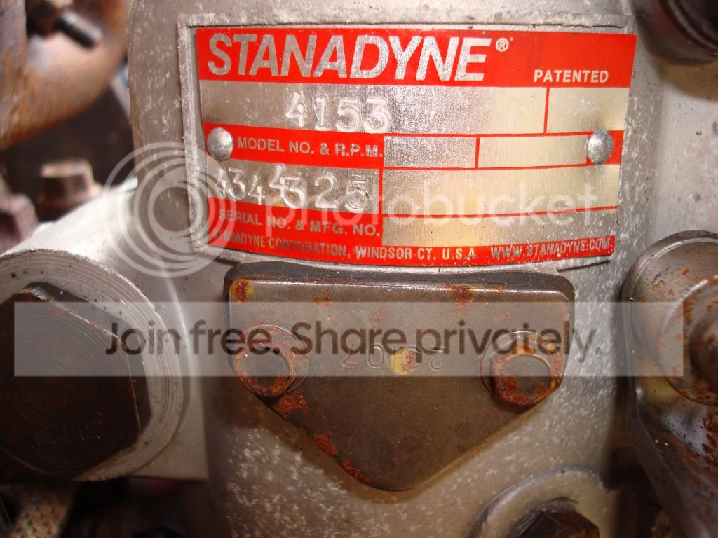

Not sure what it is called but on the side of the injection pump there is a lever that advances your pump with throttle position. Mine was broken and I had the same drivability problems that you are describing so you might look at that as well.
I was able to change the lever on mine from an extra pump that I have and man the difference was huge. I was acceleraing up hills while loaded pretty heavy and was getting 18 MPG on the trip from CO. to CA. in december.
