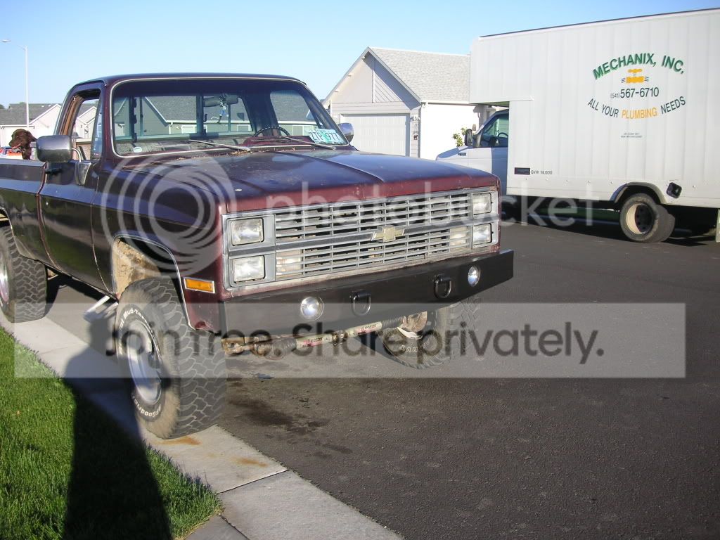

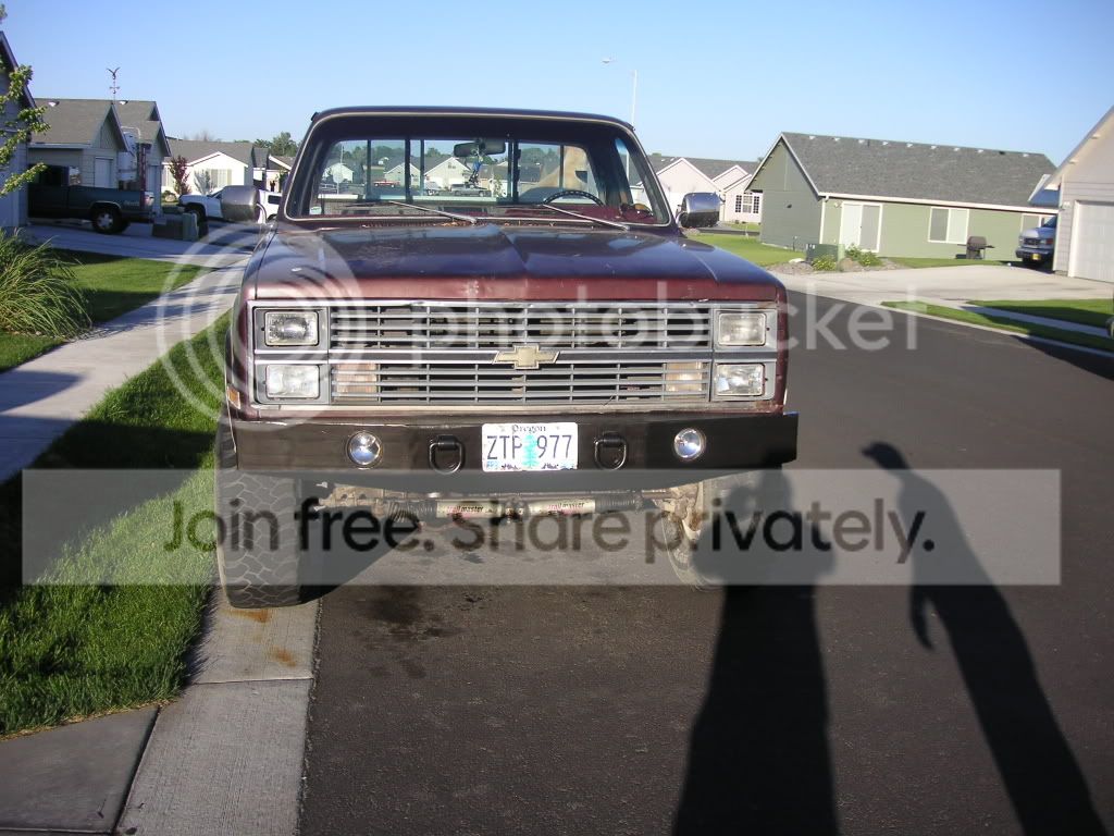

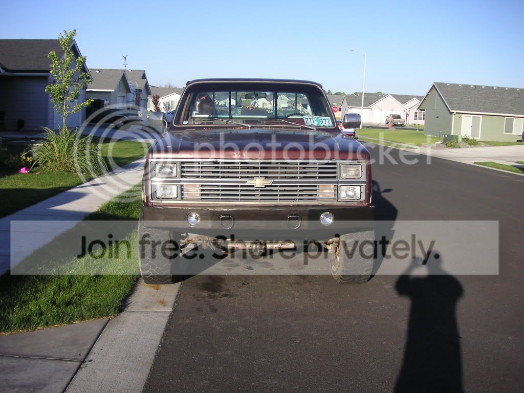

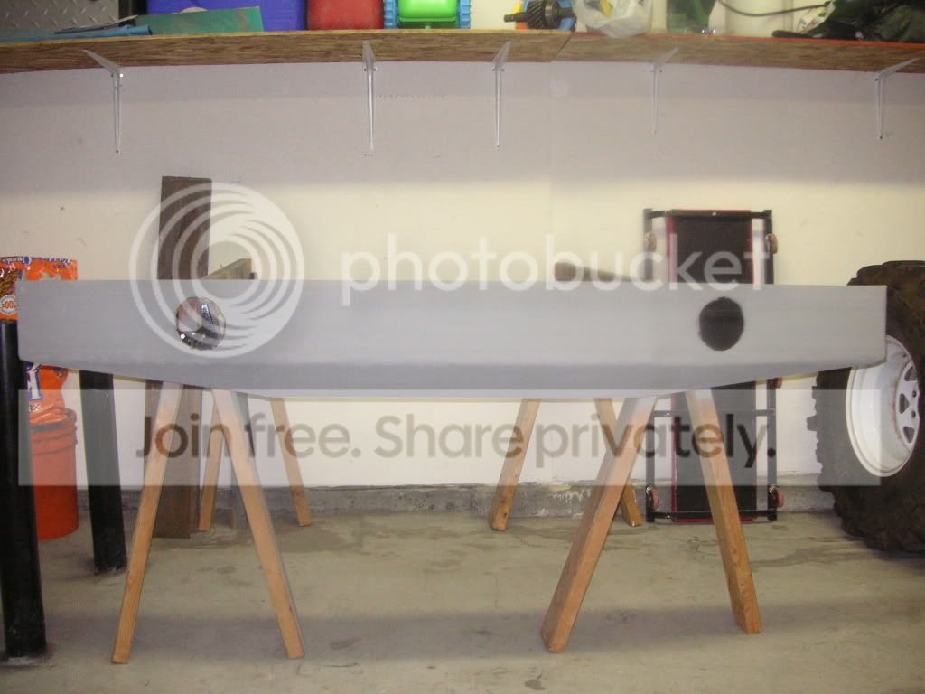

I built this out of 6" 3/16" C channel and 1/4" plate got some 4" 100watt landing lights to go in the holes, 3/4" D rings to be welded on. What do you guys think?

they are just standard 4" tractor light housings with 100watt landing lights, picked them up for about $15 each at the kenworth parts counter. they are super bright too, they are awesome in the fog, cuts right through it
did you use a bi-metal holesaw to cut the holes so good?
yes a 4 3/4" holesaw, a can of wd40 and ALOT of patience! took forever! I got about 8hours into this thing and about 6 blending discs
