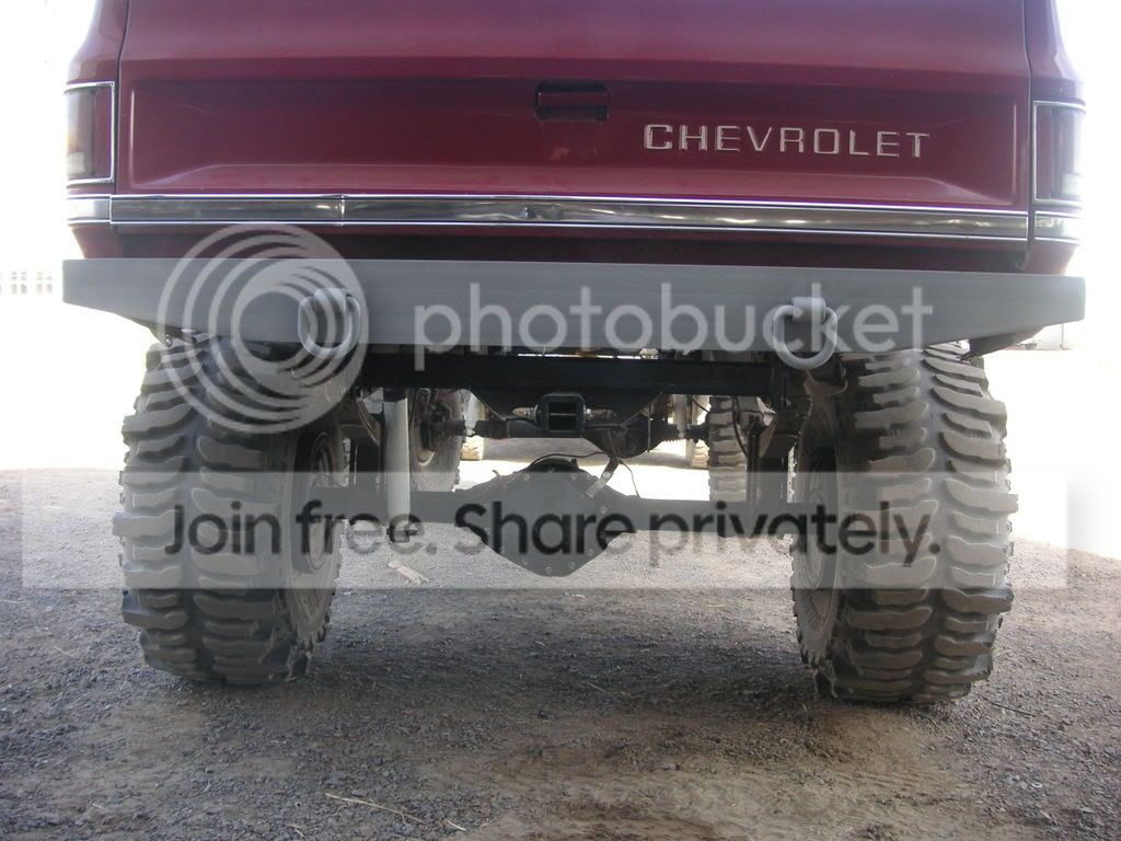

New bumper
I believe the bumper is 73" long total, i cut the piece at 80" found center, went 15" from either side of center and made a line, I V notched the sides of the bumper and heated it up with a torch, I had some 1/4"x6" flat plate that i was using for the top, So I bent the bumper down until it matched up.
I do have a rear bumper i built out of the same material, it is flat though, no bends.
