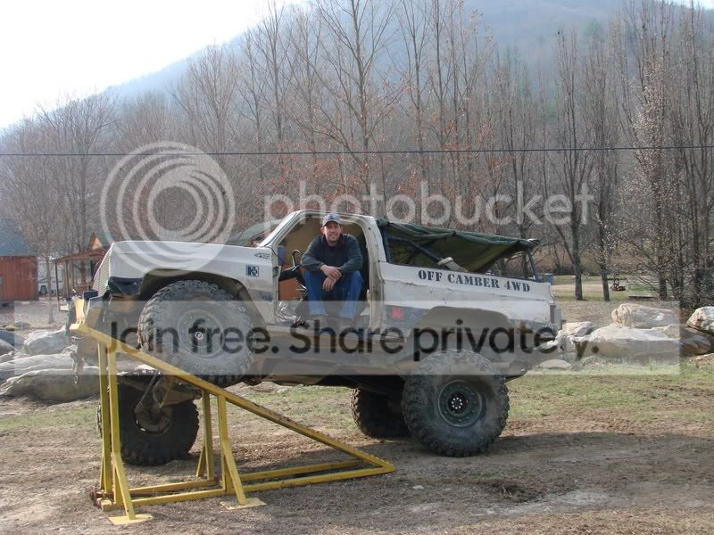

    We went up to Tellico for the clean up last weekend. I ramped it for the first time since redoing the suspension... once I get the shocks redone it should do even better.

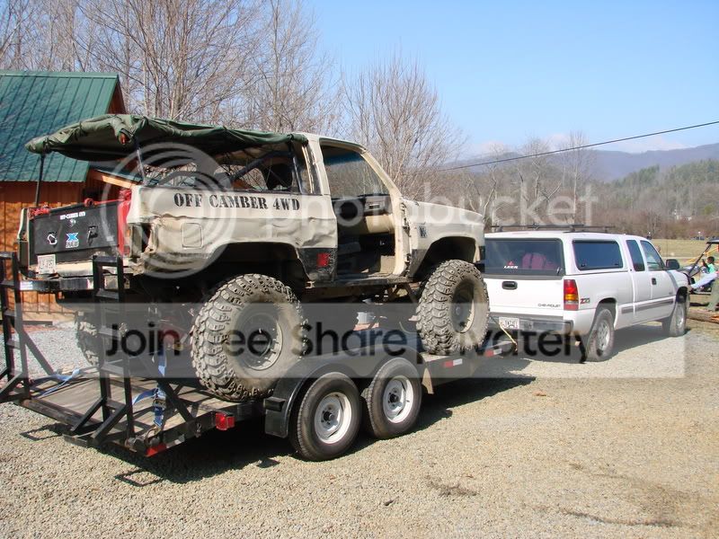

    and the new tow rig did great

    whats your tow rig have for a motor a 5.3?

    Its a chop, theres no way that 10 bolt will hold up to those 42"s:doah::haha:
    What are the suspension specs?

    yep, 5.3L... I just put it in tow mode, turn the suspension setting to firm and cruise... It also has 4:10 gears so that helps alot.
    and the ten bolt held up to the 42s all the way up schoolbus, I only had to winch at the ledge before the sideways rock... I have only seen one rig make that spot and that was with an extendable wheelbase (crazy chit) I did break an outer stub shaft when I had to back up while coming down guardrail bypass... but hey.
    the suspension flex is due to the rear shackle flips with johnny joints, I also inboarded the rear shocks... In the front I moved the rear hanger forward and made some new shackles... It will flex much better when I get rid of the current front shocks (currently my limiting straps)...

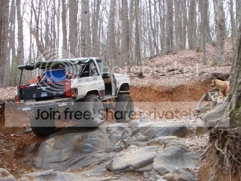

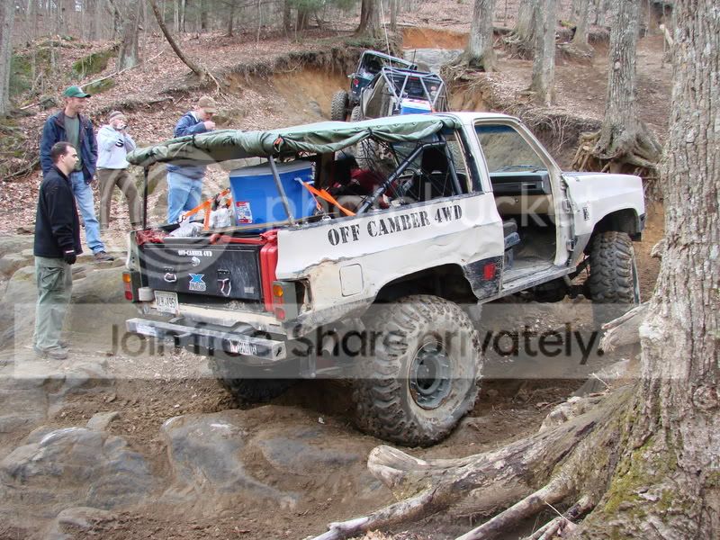

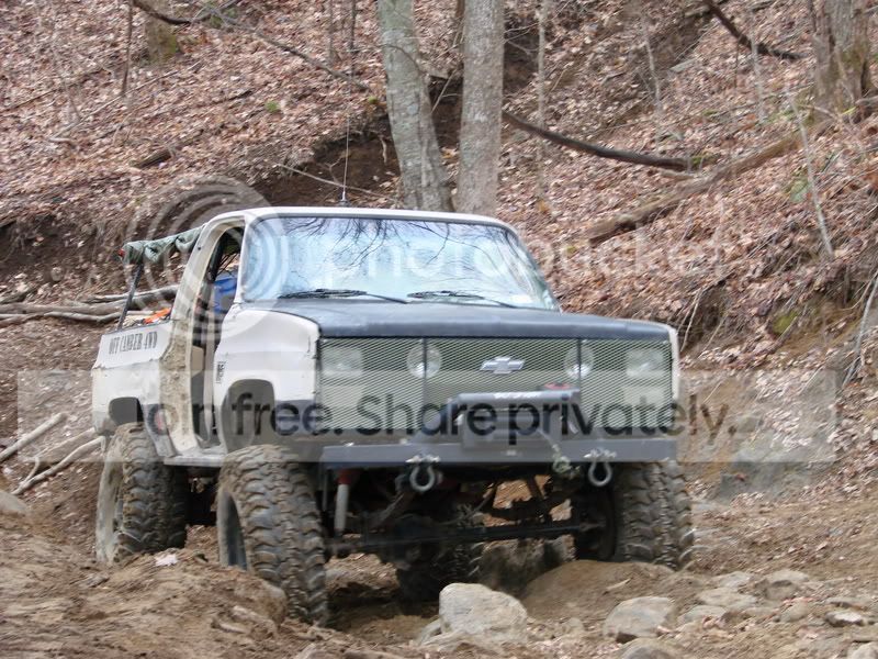

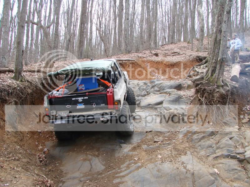

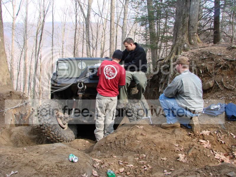

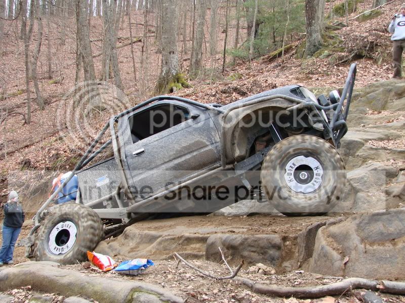

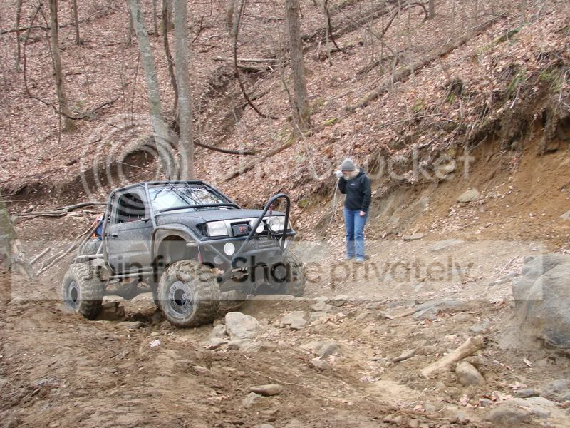

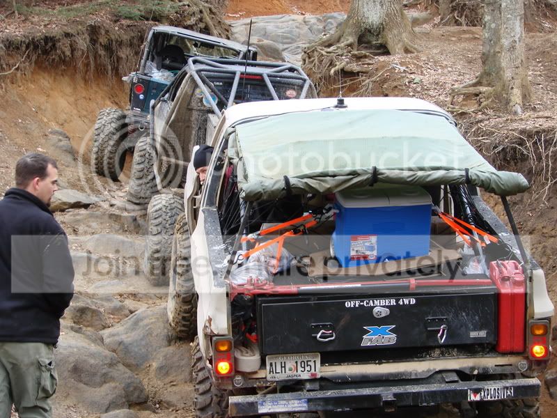

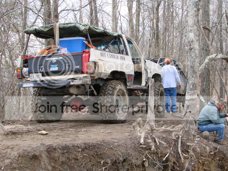

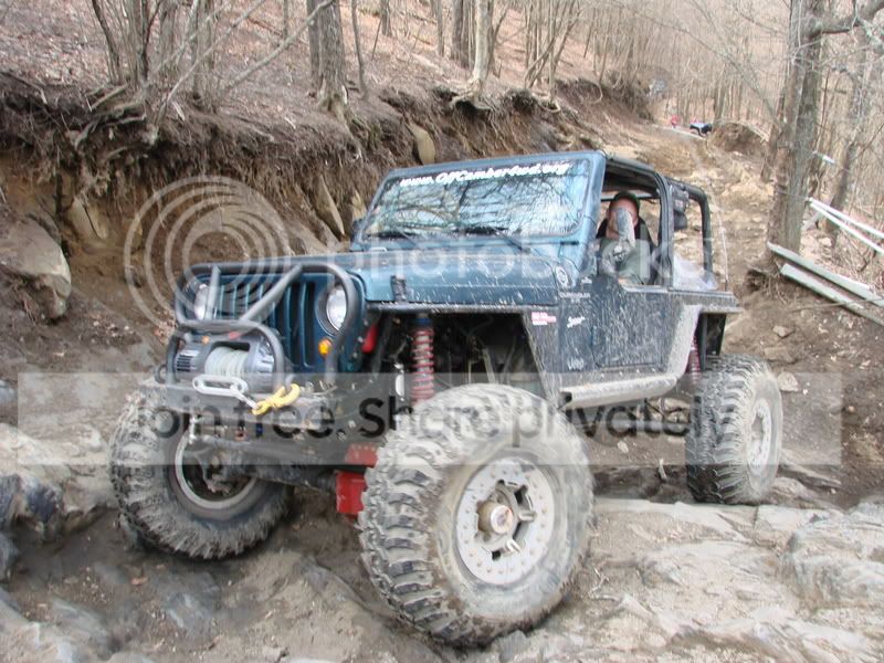

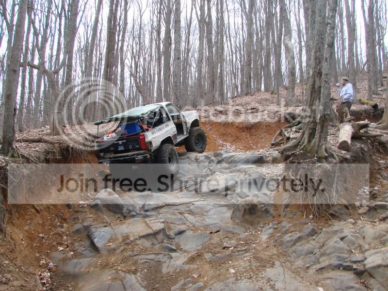

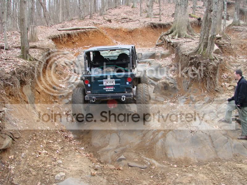

    Some action shots by request... the other two rigs are a 98 TJ and a 2000 Taco

    i see your still running a 10 bolt with 42's. hows that holding up?

    the ten bolt does ok, because I run spicer non greasable joints, and I dont push too hard on the skinny pedal... I will have a 60 soon....

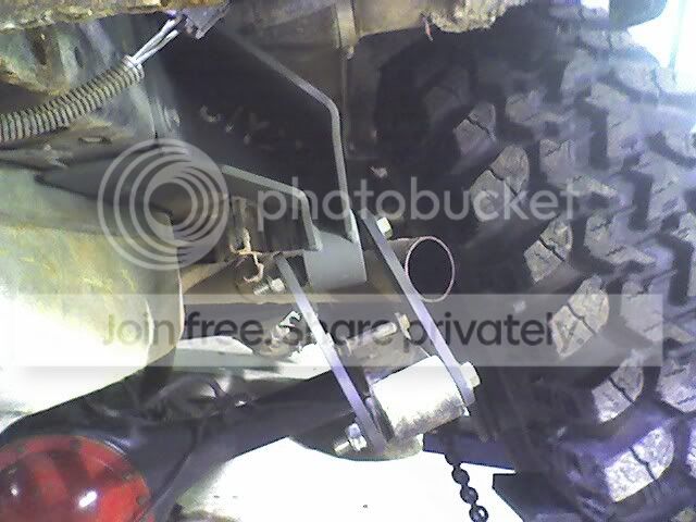

    I think its about 5 inches of lift.... Im running 4 inch lift springs in the front with the rear hanger moved forward and longer shackles. In the rear its stock springs plus a leaf or two (dont remember ) and custom flip shackles w/ johnny joints.

    did you get the johnny joints from kert, or somewhere else? any idea what your rti score was?

    Now that is one of the coolest pics i have ever seen!!

    kert built them that way for ryan22re, Im sure if you asked him to he would build some more. Its similar to the alcan superflex setup.
