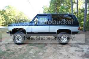

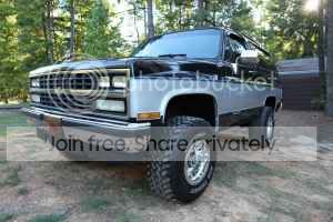

Pics
Looks not bad, but the driver's seat looks a lot more like 230,000 than 130,000 to me. Usually at 130,000 the foam is still in perfect shape and the plastic side trim hasn't busted off yet.
When you go look at it check other interior wear areas. Heel pad area of carpet, pedal pads, door handle/door pull, steering wheel very smooth (textured when new) writing still legible on the turn signal stalk...that sort of stuff. The truck will tell it's own story if you know where to look.
Be very thorough checking for rust. Most common is the lower seat belt anchor area for the front seat belts. Tailpan by the tailgate. Neither are really easy to inspect with a full carpeted interior.

If you go look at it, bring a decent camera and take a ton of detailed pic's of everything. Underhood, underbody, drivetrain stuff, detailed interior pics, etc etc...then post em up here. The pics you have are a start, but we'd need to see quite a few more, and up closer to make a sound judgement for you.

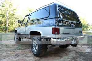

Rear bumper is tweaked, not a big deal, but look for other damage in the rear that being hidden, hopefully it was just a mild hit or something stupid... Crawl under this thing, be prepared to get dirty, check every floor support and crossmember, check where the seatbelts mount to floor near the rockers, check the rockers thoroughly, check where the floor is boxed in front of the rear tires, the tailpan... These are notorious for rusting and that new paint job could be hiding alot... Looks like a nice truck, but looks can be deceiving. For $4500 it better be perfect and need nothing fixed in my opinion. There are still a lot of nice blazers around, be patient and take your time when deciding if it's the right one for you.
