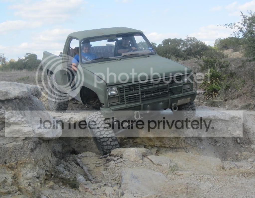

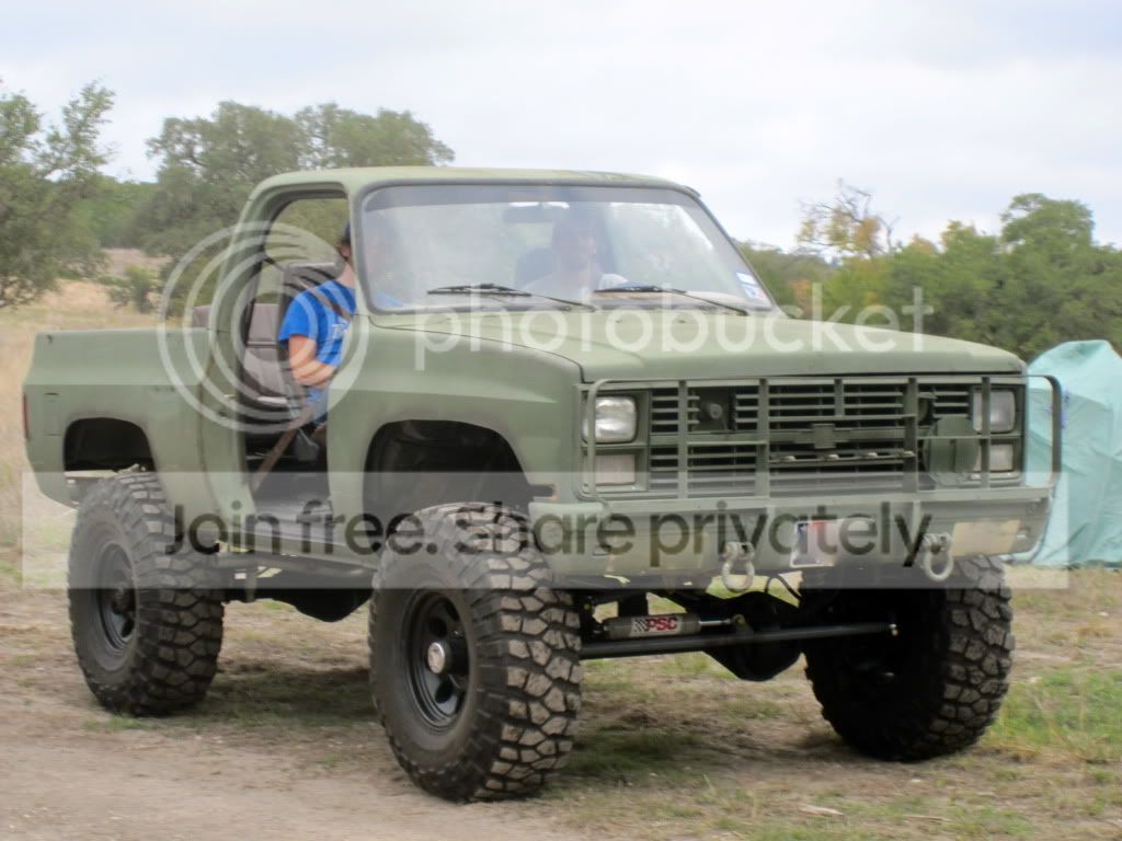

Will keep you guys posted. Here are pictures of my 1009 so far.
Coilovers and links in the front? And your front diff is on the wrong side?
I demand more info and pics!!! :waytogo:
