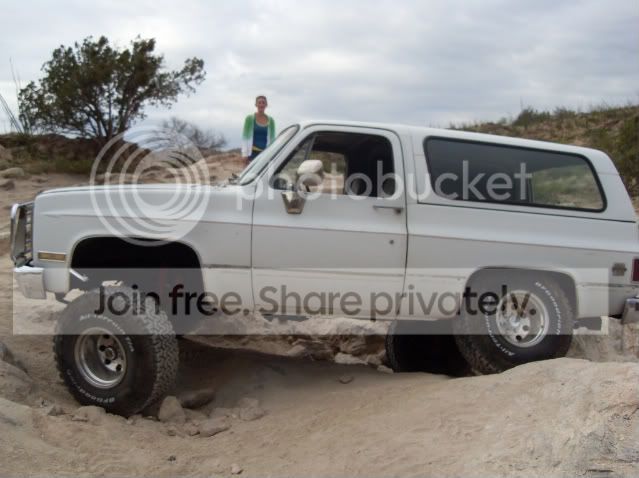

I've been driving Chevy trucks since I was 12 and have owned a few, but I just recently bought my first blazer and so far I love it! It's an 84' 305/700r4/208 with 6" rancho front springs and 4" blocks in the rear and 35" BFG all terrains and 10 bolts front and rear. Before I even picked it up I knew I wanted to upgrade it, and when a front axle shaft snapped on the first day I had it I knew it would have to be sooner than later!

I was impressed with how much suspension travel I had with this setup...but this is just after the axle shaft broke!
nice stuff pic
sounds like a plan to me
