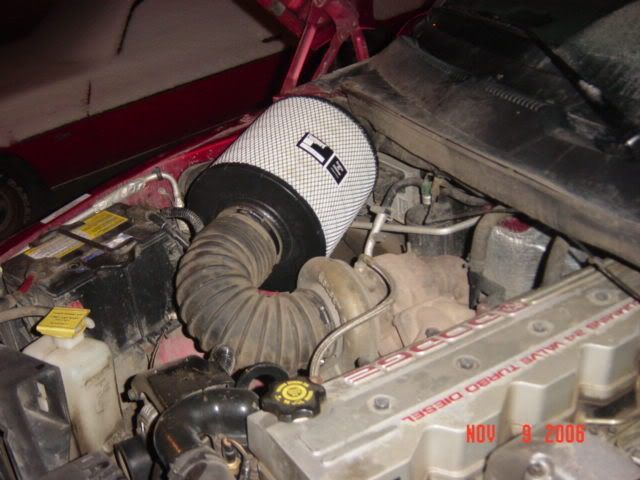

What BHAF did you use? I've seen a list of part numbers on CumminsForum but haven't put one on mine yet.

this was $50 or less IIRC at cummins. Fleetguard AH19037

I used a Wix BHAF I got from Napa I also ordered the Outerwrap for it and 4000 GSK and I'm gonna make a "100" fuel plate.
I got mine from Napa it was a bit more expensive, I did put some 3M mastic pads on the contact points off the filter
