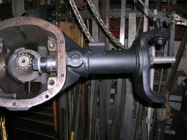

I used this pictured method to install those seals. Only pic I could find.
Threaded rod from Home Depot, some washers and socket on diff side, and same on other side...then just snug up slowly until the seal seats.
These are good seals, much better than the old style.
