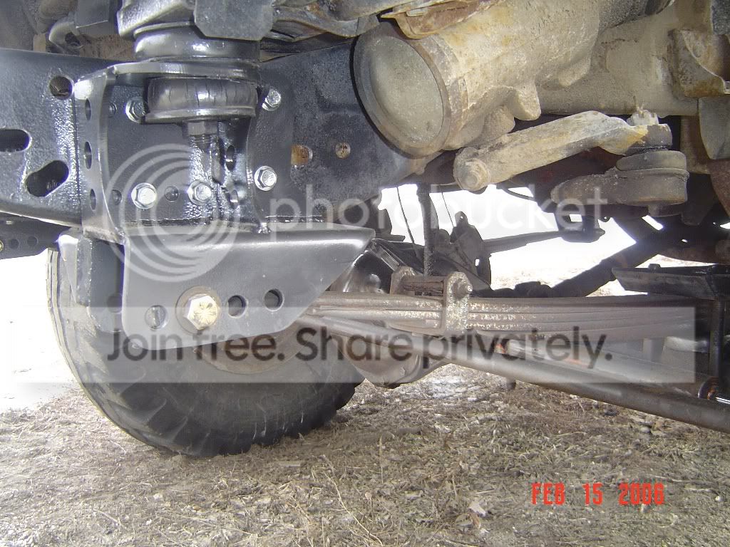

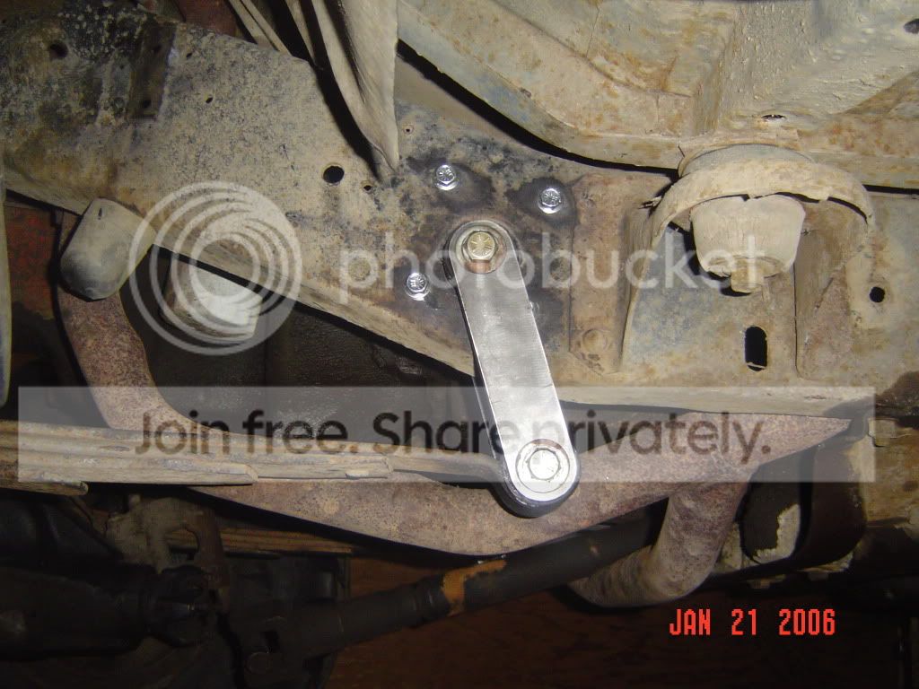

The rear shackle flip is for the rer springs. If you run a 52" spring in the front you WILL HAVE to MOVE your front rear hanger forward. If you run a 56" spring in the front (and use DIY front rear hanger) you WILL NOT have to move your front rear hanger at all. You will just have to make the hole larger to accomodate to larger aftermarket front rear hanger.So if i were to go with the 56-56 swap i just need a B52 kit and a flip shackel kit rather than moving the rear shackle point up front for the 52s. I know i need longer brake lines etc. I thought i have seen guy with 52 and stock front shackle mounts.
You dont have to buy the larger aftermarket front rear hanger though. You CAN use your stock front rear hanger and just leave it in the stock location if you run 56" springs.
