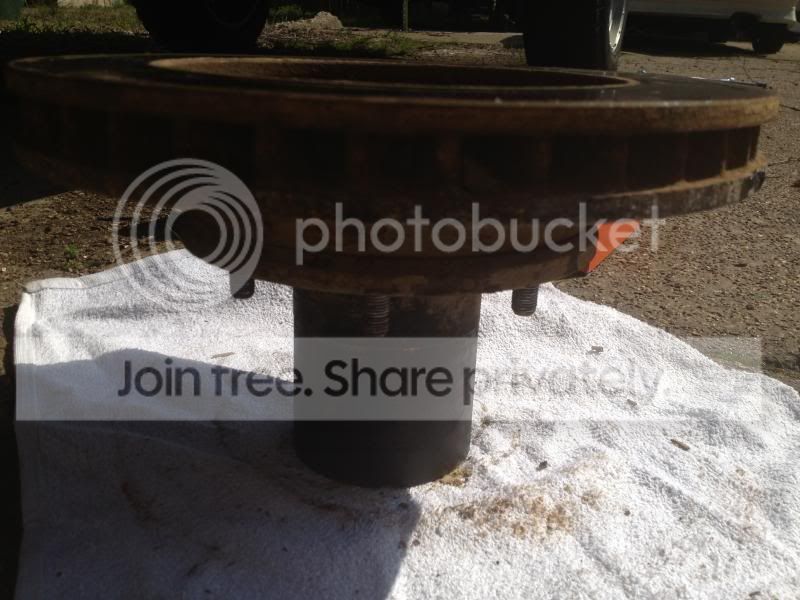

So far Ive got the rotor off and now Im stuck.

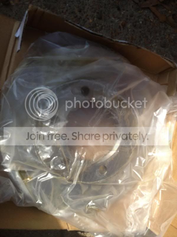

I need to know If i can take aprt the rotor and get that middle piece off of there. The rotor I have now (below) does not have this piece. Did I get the wrong rotor?

You have to knock the wheel studs out of the back of the rotor and the spindle will come off, then you transfer the new rotor on to the spindle and drive the studs back in. Best done with a press but I've made due with a hammer. Make sure to use a sacrificial lug nut to hammer on when driving them out, do not hammer the stud thread side without a lug nut on there or you will ruin the threads and have to get new studs.
Try Summit to order a set of lug nuts. They should have something to match.
Ok Thanks, I have new studs already so Im not worried about messing up the old ones. Back to it.
Just be careful you don't mushroom the head at all, because then you get to have fun cutting the stud. I've hammered them out without a lugnut on there without issue before, but being older and wiser (hopefully) now I wouldn't do it again. Since you're looking for new lugnuts anyways, I'd go ahead and sacrifice one.
