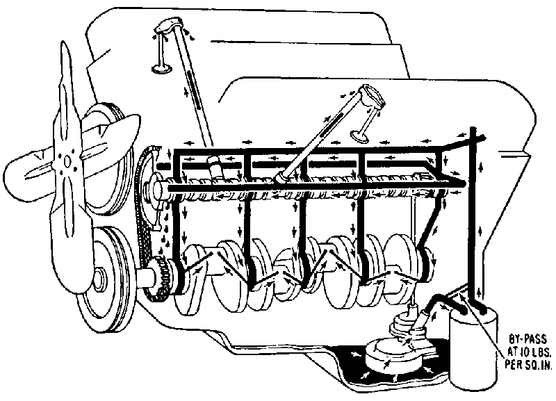

I have to admit I don't entirely understand the oil pathways from the oil pump through the filter and the different bypasses etc??:doah:
Thanks Ryoken
So if the pressure difference across the filter is greater than 10psi, the bypass opens.
From the diagram it looks like the bypass is part of the block, so I couldn't have accidentally removed the bypass, or effected bypass routing, when I took out the oil cooler adapter plate. (can anyone confirm my conclusion?)
Does anyone know exactly where the oil pressure tap down by the filter taps into the the galley? I assume it is in the vertical riser AFTER the bypass? Does anyone know for sure?
Is there anyway the oil could have been circulating and a mechanical gauge at that tap would've shown zero? I can't think of one...
So...now I'm confused...from the pics eagle posted, it looks like the bypass is in fact ENTIRELY within the spin-on filter adapter plate and not in the block at all?
yes, that's correct.. that diagram is misleading in that regard, it's just meant to give you a general flow direction.. ... there is no bypass in the block.. how could you boil the block, etc in a machine shop...
