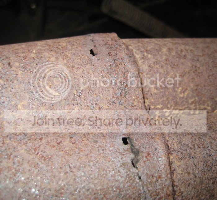

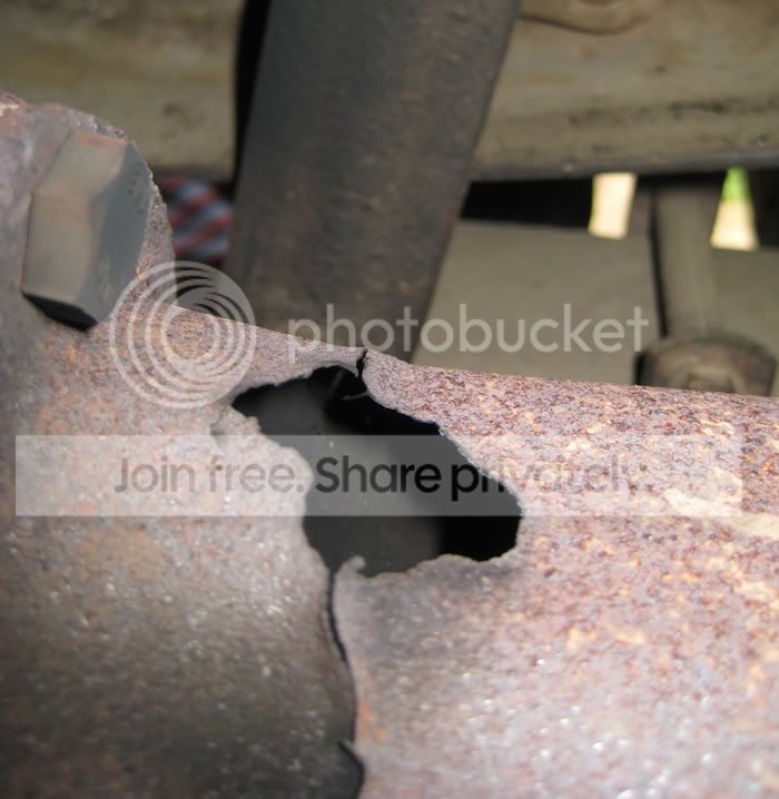

So I'm changing the oil today and I see two little spots on the driver's side collector. Hmmm they look like they might be holes. Got the pocketknife out and sure enough the tip went in. Started feeling around the top side of the header and lost my finger in a quarter-size hole! You guys think this wouold cause an annoying exhaust noise?! Maybe headers (even thin-wall) don't sound so bad after all :rolleyes: . This hole points right up to the floor at about where the pedals are so I didn't see it while laying underneath the truck. I'm pissed that I didn't check better but am relieved to know the source of my noise.
I'm still gonna go stock manifolds but I'm off to the parts store to get something to cover the hole in the meantime.
Here are the pinholes that caught my attention...
And the gaping hole that drove home my suspicions...
You will hear me brag no longer about my Hooker Headers that were put on in 1977. They're played out and rusted out. :D
Well that's your problem right there! :haha:
You should have seen mine, when i first got my truck, each side probably had a hundres small pinholes... plus the pass. side muffler was blown out... it was a loud and long ride home that day on the highway.

Well I buttoned up the hole to get me by until I get my manifolds. Man is it NICE & QUIET :). Now I can enjoy the low, throaty tone of my Super Turbos and not the open header underneath my front floorboard.
So nice to be able to get on the gas a little and not wake up the dead in the graveyard across town.
