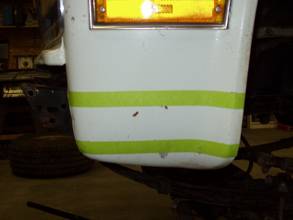

Started with trimming the front fenders to a complete makeover.

Getting ready for the knife...

I like how you did the front portion of your front fenders. I just cut mine off and welded the seam accros. Again, nice job :waytogo: How long did it take from start to finish? Mine is still stripped down waiting for funds so I can get all new rubber...

It took me close to 3 months. I did all the body prep myself and brought it to a friend of mine to paint it in his booth. Go here and you can see more pics of the fender cut. http://www.m4x4a.org/index.php?module=mGallery2&g2_itemId=41985

It is the UD1 on a diet... Kert made some mods to slim it down since I cut over 2" off the nose of my front fenders.
