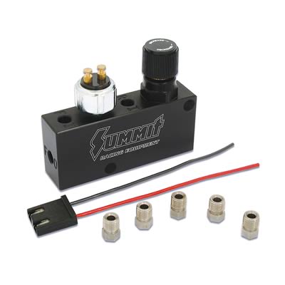

I'm gonna run this valve... complete control of the front/rear bias...
