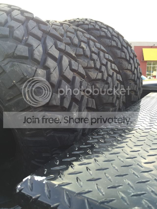

Well I found 5 37" SSR's with new spare but others are little worn then I found 5 37" Nitto trail grapplers (which I have on my diesel) for 800. 80% tread and spare is brand new! Very very tempting to get the Nitto's even though they are heavy tires

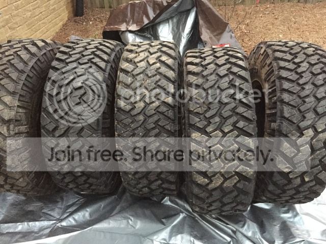

picked up 5 37/12.5r17 Nitto trail grapplers today for 800! 4 of them are about 85% and one is 100%. These are a little heavier than most tires and E rated but I love them under my diesel tow rig.

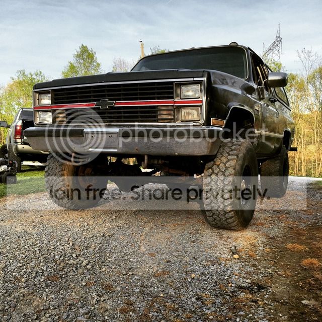

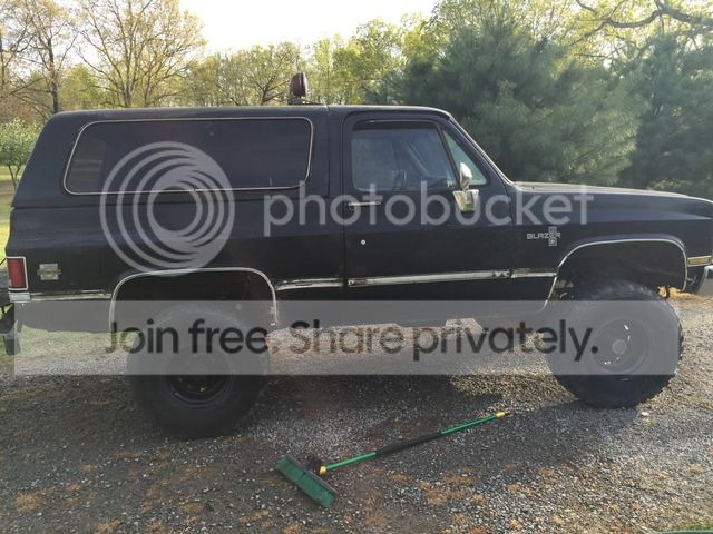

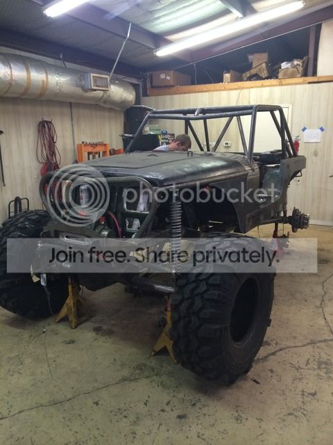

Also here are some better pictures of the K5 itself I took the other day. Can't wait to pick up my 2003 silverado seats and perfect dash.
Sweet rigs guy!

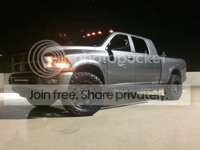

I wish I had those ultra light rims like the ones on your jeep! :haha:

Thank you! and Yeah now I have some slightly heavier Trailready Beadlocks for it
Good luck finding that combo! a 5.9 6spd Mega is like a holy grail truck. That is why I ended up buying that truck in 2010 because I couldn't find one that wasn't almost the price of a new truck.

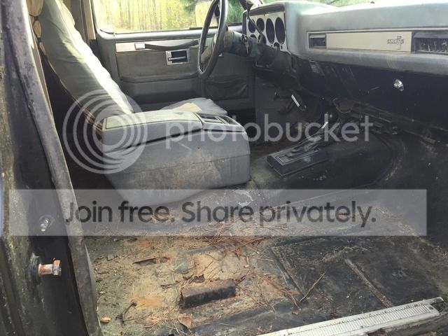

- Picking up Two cloth grey 2003 Tahoe buckets this week for 75.00 each from a local salvage yard, Yes I've found them cheaper but i'd have to burn diesel going to get them. No rips in the seats as well!
