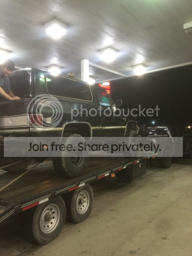

Some backstory: I've been really wanting something I can drive hunting, take the top off in summer and do some light wheeling with since my rock crawler is so purpose built and not even close to street legal. I originally wanted another jeep but finding a cj8 is hard and they are way to small for what I want to do. So naturally I turn to one of my all time favorite vehicles.. the K5. Started looking in my price range and found plenty of stock ones, then I found one on some 3/4ton axles and that led to lets find one on 1 tons.
I know myself well enough that no matter what vehicle I own, I will always change tons of stuff on it and "overbuild". So I found a 84' on CL in Alabama with 12k miles on trans and motor, dana 60/70 combo with 4.56's and Detroits, grabbed my trailer and bought it last night. Kindof an impulse buy but the price was right at under 3k and it has a great drivetrain.

Pulling it home

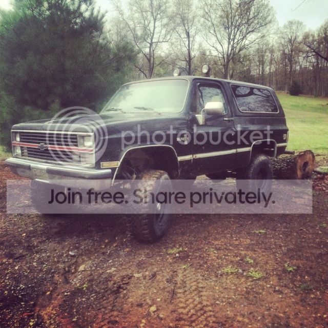

This morning
