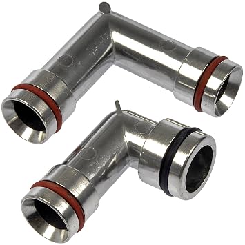

There are 2 coolant elbows on the 99+ and only 1 on the earlier ones ('03 will still be series II). Either way, the kit you want is the 47065HP from Dorman.
They are aluminum - I've never seen any steel ones. Any site selling 3800 stuff will have them. I found a set at Autozone, although I don't see them on their website. I do have a small pile of used plastic ones if you wanted to take your chances. They are OK for a while (they usually make 100,000 miles anyway) but prone to breaking whenever you take things apart. For the $12 or whatever they are at a retail store, the aluminum are well worth it. I have heard of the pre-installed O-rings leaking and a better O-ring from AC Delco, but I've never had leaks from either of the sets I've installed. Just be sure you get all of the old plastic and O-ring out first and give the holes a clean-up before installing the new elbows.
http://www.amazon.com/Dorman-47065HP-Elbow-Type-Heater/dp/B00A1A6PT4/ref=au_as_r?ie=UTF8&Make=Buick%7C45&Model=Park%20Avenue%7C390&Year=2003%7C2003&carId=1&n=15684181&newCar=1&s=automotive&vehicleType=automotive
EDIT: Looks like O'Reilly and Autozone have it - probably everybody. RockAuto is only $6.67.
