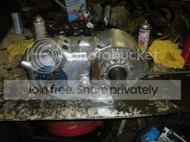

i dont know if you could do it with a fig8.you prolly could .my round 205 i redrilled the face of when i did the 32 spline front.thats the chheapest way imo.here is a pic
