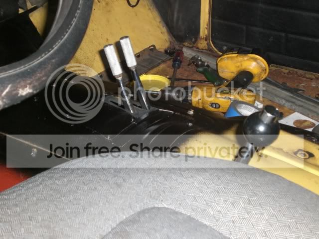

I have a 1977 Blazer with a np203 in it. It has been converted with locking hubs and I presume something in the tcase because there was some old worn off instructions pasted to the dash about lubrication. I have since split the shifter to make it a twin stick set up. For regular street driving which chart should I use? Im guessing that the left lever is forward and the right lever could be in either forward or back?
If you have a part time kit installed then you would be using the "part time 203" chart. The left lever will be forward for 2wd or back for 4wd and the right lever will be back for normal driving and forward for low range offroad wheeling.
