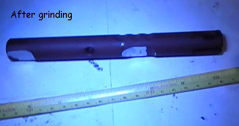

Have a recently rebuilt NP205 that I bought from someone locally. It has a twin stick setup and the selector shift rail was modified from the previous owner. The front drive will not go into low range no matter where rear is shifted (H, N, L). I was going to remove the selector shaft rails and inspect it. Anyone have some ideas on what else I can look at?
Look and see if the front shift fork is actually on the collar
Thanks I'll look for the fork on the collar and good pictures on NP205!
