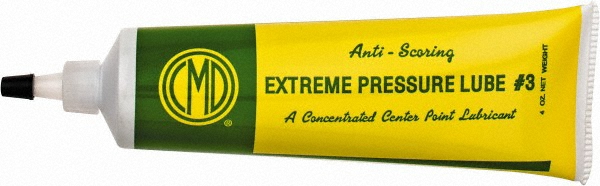

I checked it like a dozen times, I am pretty confident its good. Guess I will grease up the drive shaft. What type of grease should I use? Don't want to contaminate the transfer case fluid.
I would start by pulling the driveshaft off the axle and pulling the slip apart. See if the splines look good and check that it moves freely. I tend to just lube with wheel bearing grease but that will need more maintenance. Something even thicker would be best. I put this stuff in my U-joints since I don't run needle bearings. You wouldn't need much, stuff is awesome.
