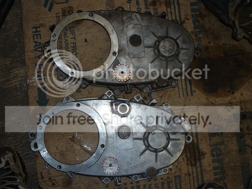

Aren't the drain plug and fill plug the same? What about swapping them?
Mine has 3 plugs and they're all the same. I have parts from 3 208s and all the plugs are the same.
