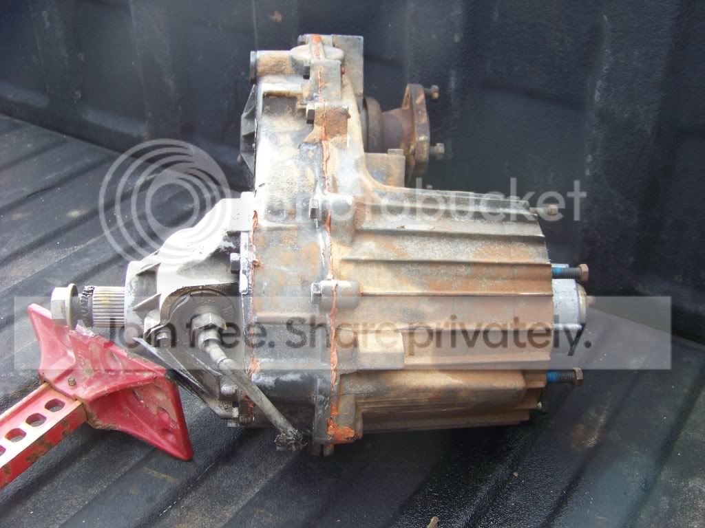

They machine down the housing to make it shorter, give you a new shorter shaft with the end of it drilled and tapped.
Here's a pic
you can also use the back half of a dodge np208. i forget what little mods you have to do, but it can be done and much cheaper than the kit posted above. I had collected the parts to do the conversion, but never got around to it and sold the parts.
No, it's just upside down. Dodge has the speedo cable coming from the DS. Look at the drain plug.
