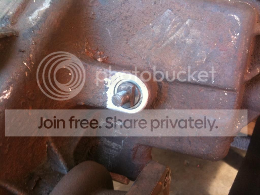

np241: How do you replace this? (see pic)

You are looking at the shift selector. That is a nylon ring, and I believe an o-ring is behind it. I really don't want to open this thing up if I don't have to, but I have a leak from this point.

Take a sharp, pointed pic- or sharpen a nail to a point and work out the nylon ring. Then the o-ring next. Spray some degreaser around the shift shaft. Clean the nylon ring. Match up a new o-ring from the hardware supply. Put a little vasilene on the o-ring and install using a small screw driver to push it in evenly. Then install the nylon ring. Or if you messed up or lost the nylon ring, I have used two o-rings. Should go together easy. Good luck.

Thank you! So you have done this exact thing before? I only ask because I am installing a new tranny and don't want my limiting factor of completion to be a nylon ring, and I think it would be ten times easier with the case on my garage floor. Thanks again

Thanks for the help. :thumb: I was able to get the them out without much trouble (the nylon ring is still in one piece). Lucky for me I already had the correct sized o-ring in my collection!
How did you end up getting this replaced? What tools/methods did you use?
I used a sharp pick and a tiny flathead and worked it out slowly. Gently poke and pry and try not to gouge it too much. A pick with a curve is good to get the o-ring out after the nylon washer comes out

I ended up taking a straight, sharp pick and lightly hammering it straight (90*) into the nylon ring. Then I pushed the pick handle to the left and right to work the nylon ring out. It took me a couple of tries, but eventually I worked it out.

I used a different pick. This one has multiple angles at the tip, and allowed me maneuver it under the o-ring and then I could twist the pick's point to a position that allowed me to "grab" the o-ring and pull it out.

To install the new o-ring and nylin ring:
I lubed the new o-ring and the nylon ring with some silicone grease before installing. I used a small, flathead screwdriver to carefully push the new o-ring in. And I did the same for the nylon ring as well. :waytogo:
