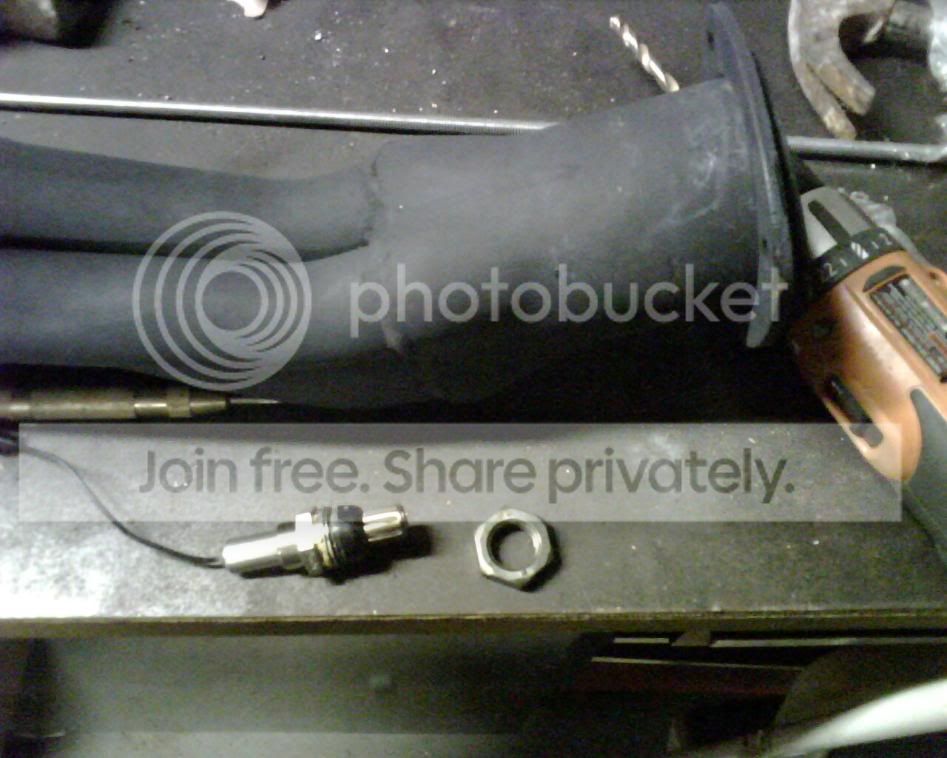

Summit has em. I bought one. Not really worth the 3 dollars, quite honestly, but couldnt find one. I have a pic of it somewhere... look for my bring er back thread, I know its in there.
You can however, go to home depot, and fit one up in their nuts bin. I think they do have them that large. If you go that route, make sure they have a thin nut, so that the o2 goes in deep enough.

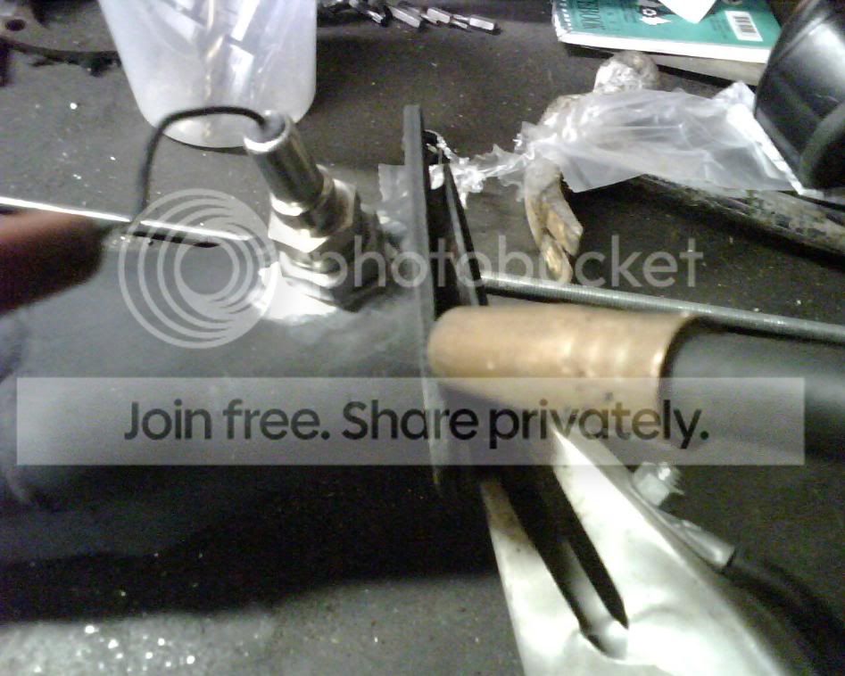

Here ya go.

Pookster, thanks for the pics! That's exactly what I need to do! Perfect! Thanks for the help!:waytogo:

I also put it in the collector- you can put it where you like but that is going to be the hottest pickup point. If your doing a stock y setup, if you can find somewhere where the two banks meet up that would work better (as your acutally getting the 02 readings from both sides). I only have it setup to one side (true duals). And last I checked, the TBI ecu's arent advanced enough to have sensors for both sides.
I had to go to a local bolt/nut supplier, no luck at the generic hardware stores, but for $1.50 or so (I think) I was out the door. If they've got it, you really want a jam nut, as they are thinner and put the O2 sensor more in the "stock" position in the exhaust stream.
