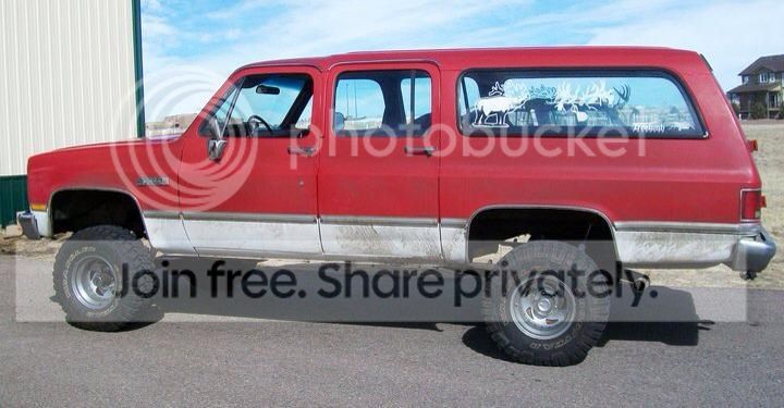

It started in 2009 when I purchased this 1987 GMC Suburban 1500 from my father-in-law for $1500. He was the second owner and at that time had owned it for half of it's life. We knew EVERYTHING there was to know about this vehicle.
I immediately started using it as a hunter transporter for Guided Elk/Deer hunts as well as Fly Fishing trips. It was a very trailworthy rig stock as I could get it into places with strategic driving while hauling as many as 7 hunters and guides with all of their gear to/from camp.

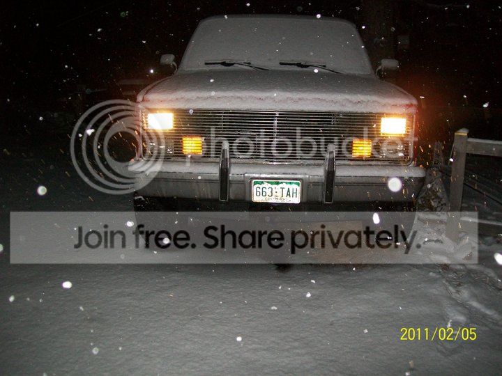

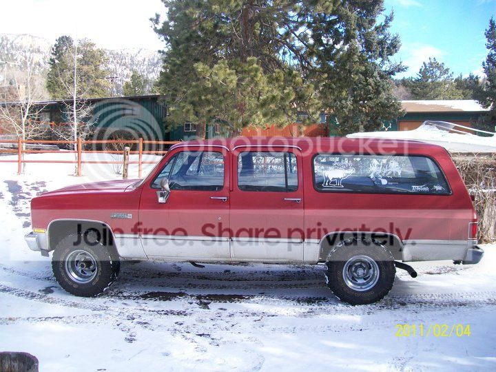

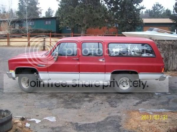

This is where I started in the beginning of 2011.........

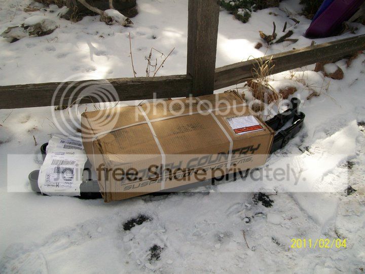

it started with this package showing up at the door......it was all I could afford at the time so it was something I knew I could use as a foundation to build off of.....

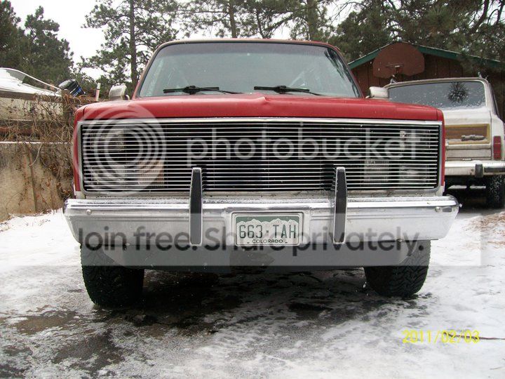

I also installed this grille at this time to give it a little upgrade on looks since I had taken out a whitetail buck in Nebraska the summer before :whistle:

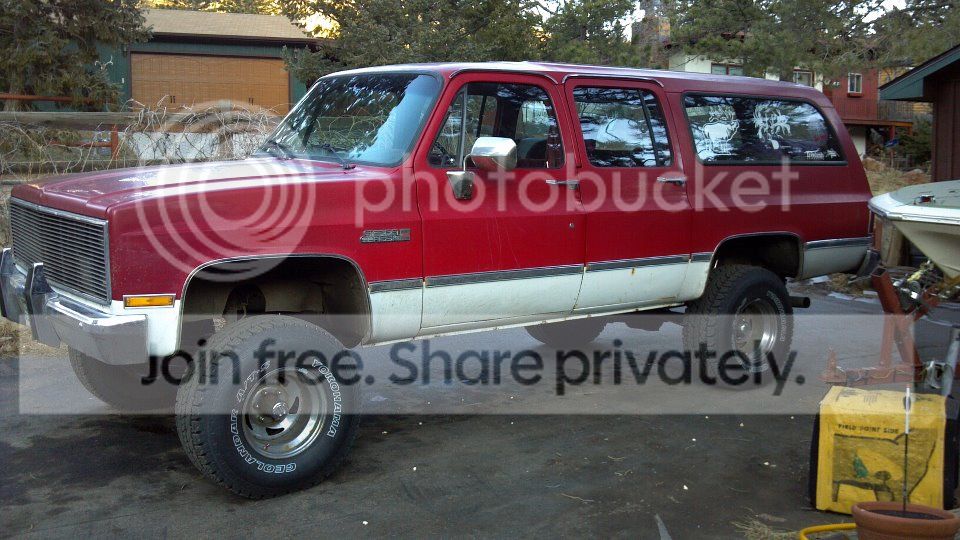

Some Colorado CK5 Members from the Colorado Springs area installed my Rough Country lift, new brakes all around, and ORD steering brace for me :bow:

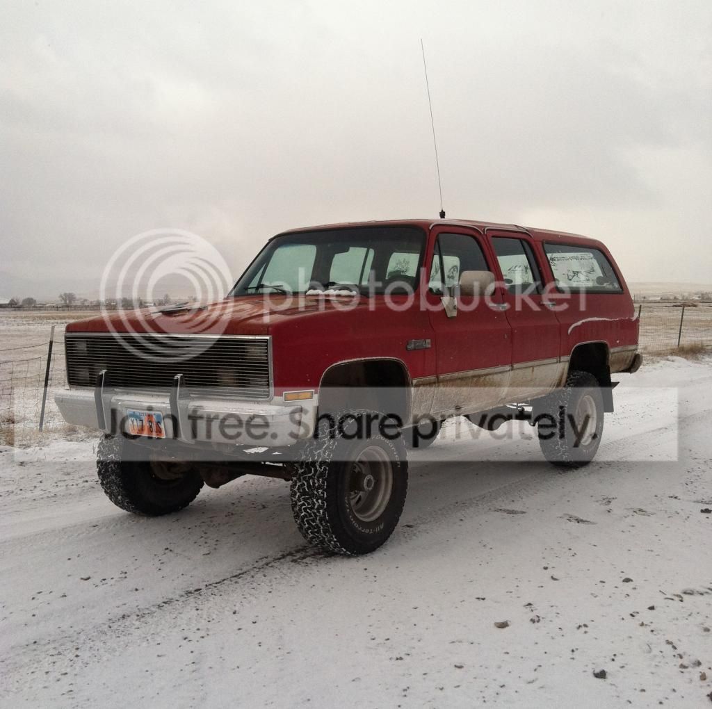

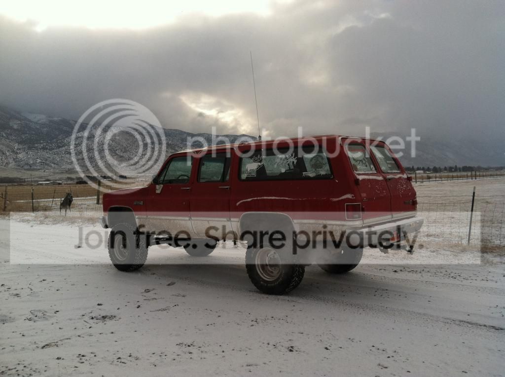

and this is how I drove it through March of last year.........when I was offered a job in Utah. The adventure began here........

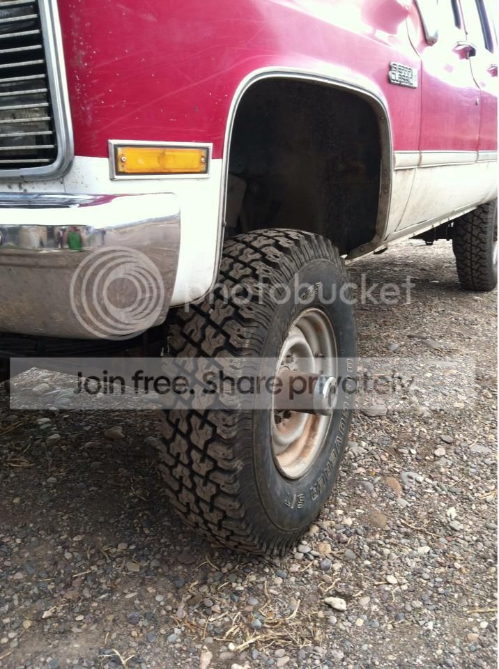

New tires to make the trip to Utah a little easier :thumb:

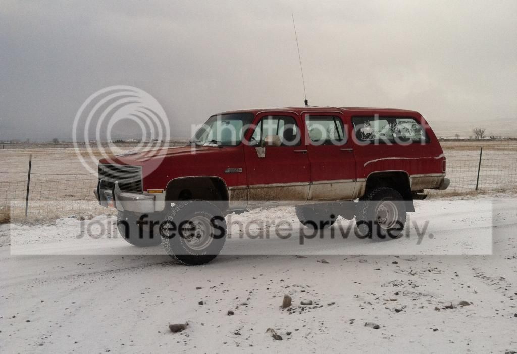

I found a set of HD D60/D70s out of a 92 Dodge and it was all over from there. I'm sorry I don't have more pictures of what I built and along the way. This thread so far is just going to be pictures of along the way so we can get to where we are now so that I can take better notes from here out.

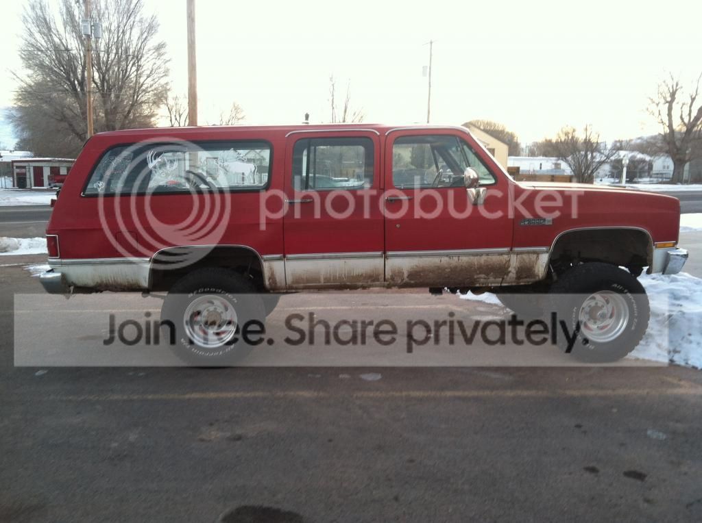

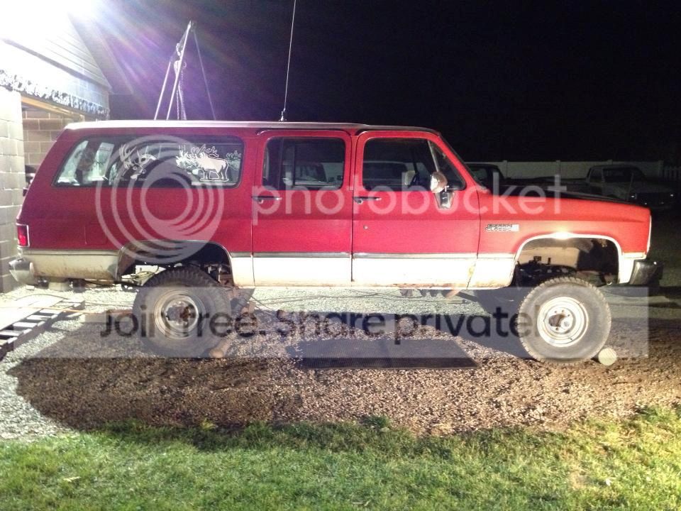

Custom Rear Shackle Flip with front hangers off a junkyard donor......:whistle:
Saggy "Squatting Dog" syndrome set in and I started to look at what to do to sit it level.
The Front D60 had lifted it 2" making my Rough Country 4" front springs and my shackle flip not match up.........
so I added some 2" Blocks and some Nitro8000 shocks to add some positive lift and ride to the arse........
